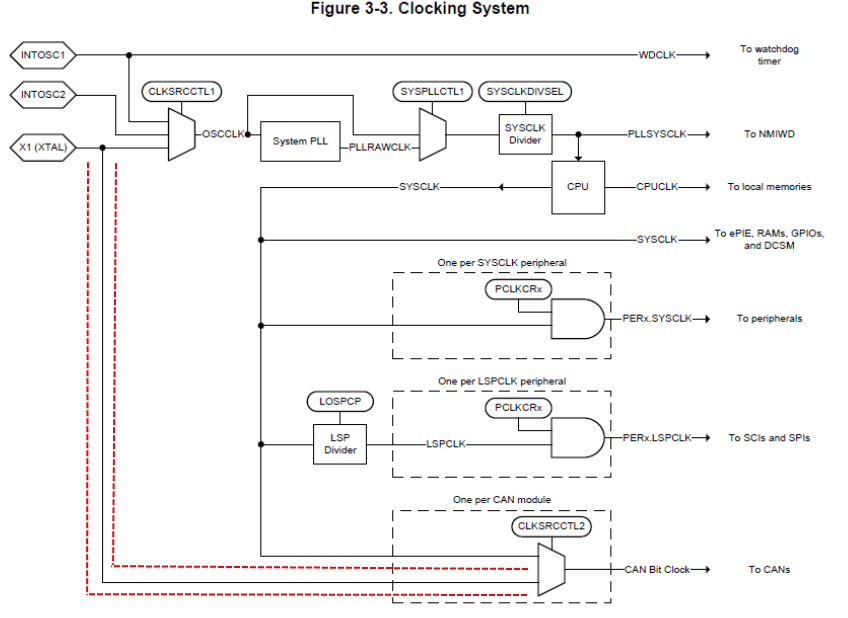

We are using the F28004x ControlCard and docking station. We have an external CAN transceiver that works with the F2837x ControlCard, I am having a difficult time getting the CAN working on the F28004x ControlCard - probably a clock setup issue. As noted in the reference, the external 20 MHz clock can be brought directly to the CAN clock input - however, I am unsure of what if any functions to call in order to set this up. Am I missing something? (I know, left myself wide open on that one...)
  • OK, looks like I was able to set up CAN to use the external 20 MHz clock on the ControlCard.
    Based on the discussion from the referenced e2e post, here are the key function calls:

  • Todd,
                I presume you ran the C2000ware example “as is” to start with.
    Can you confirm you are using the clock path highlighted by the dotted red line in the attachment? I presume you are writing to the CLKSRCCTL2 register to switch the CAN clock source and changing that frequency to 20 MHz.
    What bit-rate are you using? Does it make a difference if you use a very low bit rate like 50 kbps?
    By any chance, are you using the 10 MHz internal oscillator (INTOSC)?

  • Hareesh:
    Yes, I am using the path highlighted to supply clock to CAN (20 MHz on ControlCard). And as far as I know, I am using the same 20 MHz clock as an external clock source. However, trying to route the SYSCLK to CAN did not work on my particular ControlCard. I will try another ControlCard that is present here, to see if it exhibits the same problem. The code is based on C2000WARE, but is custom code that was ported from an F2837x ControlCard.
