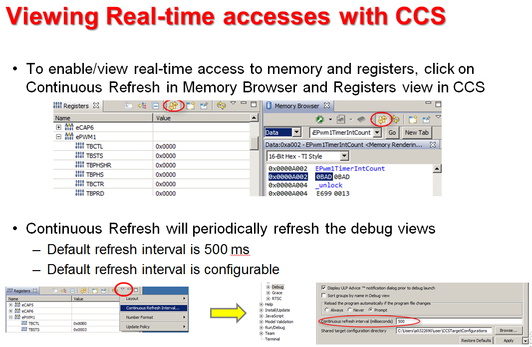

    One way to possibly get around this is use polite continuous refresh mode and also reduce the frequency at which continuous refresh is done.
    Enable Polite continuous refresh mode mode by going to CCS menu Run->Debug Configurations->Target  tab
    and also reduce the frequency at which continuous refresh by method shown below.

    In CCS under the "Window" menu item, select "Preferences". In the new dialog box select "Debug"(don't expand it, just click on Debug). This will bring up a preferences menu that near the bottom shows the continuous refresh interval. The default is 500ms, can you confirm this is the setting for your CCS? If you try a slower rate, does it help the Illegal ISR happen less often?

    thank you for your help. I tried the Real-Time-Mode as Manoj suggested, seems that this really helps. No Illegal ISRs anymore during my tests so far.

    We had some internal discussions on this, and the real time mode will influence the behaivor of the continous refresh, making sure that "Polite"
    real time is selected(I think it gets highlighted as well on activation of real time). Left alone the continous refresh is in "Rude" Realtime by default and could hold up some ISRs if too intensive.
    We don't have any instance of code corruption per se, so this must be some artifact of the rude vs polite that we are seeing. Let us know if this rears its head again, but I think the above aligns with what you tried based on Manoj's suggestion.
