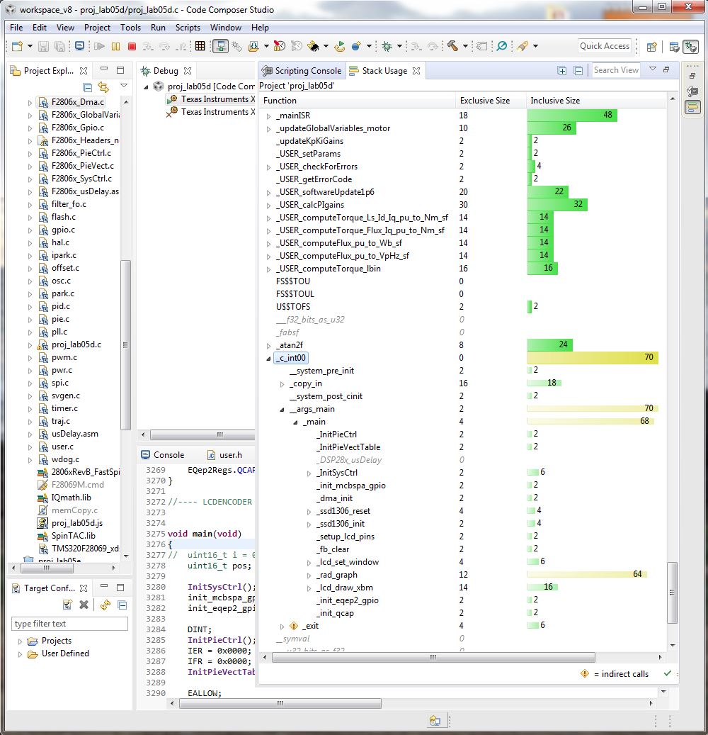

I am trying to use the gpio header from driverlib to be used in the Lab05d.
While compiling, I do get an error:
>> Compilation failure
subdir_rules.mk:135: recipe for target 'proj_lab05d.obj' failed
"D:/ti/C2000Ware_1_00_04_00_Software/device_support/f2806x/headers/include/F2806x_Gpio.h", line 55: error #20: identifier "Uint16" is undefined
What other headers need to be included to use Uint16 ?
I tried including stdint.h anf stdlib.h, but that did not seem to have any effect at all. Which headers do you suggest ?
Any thoughts ?
Manu

  • Update:
    Had to add F2806x_GlobalVariableDefs.c to ProjLab05d to get DmaRegs and GpioCtrlRegs.
    During inking phase, things do not seem to look well. Scratching my head, what to do next.
    Any thoughts/suggestions ?
    Manu

    It states 70 out of 70 bytes used. Is t possible to increase the stack size, if that's the case ?
    Manu
  • Sounds like some macros are double defined in your case. You can choose to surround them in a "ifndef" conditional statement to make sure they are not already defined.
    You can increase the stack size in the CCS project settings
