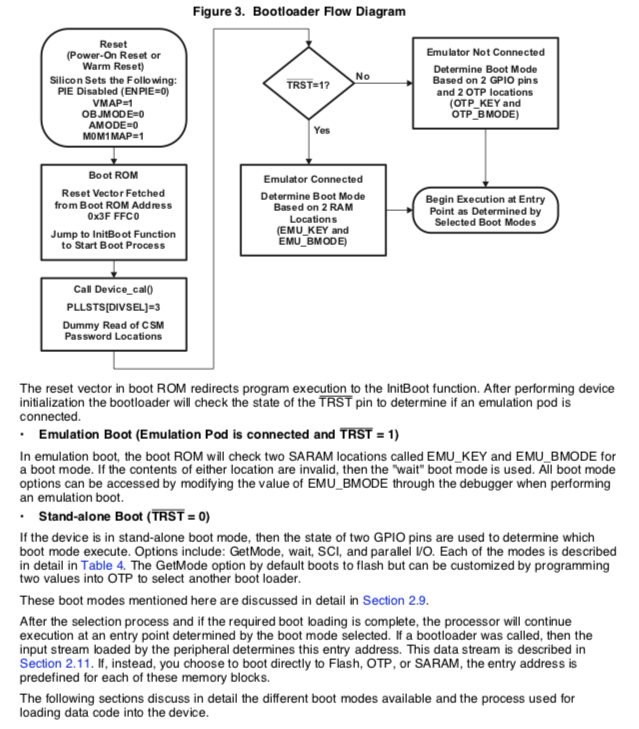

    i think the issue is something with the boot mode configuration. From the technical reference manual (SPRUFN6A) i noticed that the device does a check on some memory locations to determine boot mode (EMU_KEY and EMU_BMODE) before beginning the execution of the program. It also says that if some of the locations are invalid, then the 'wait boot mode' is used (see attached image), where the CPU keeps looping within the boot ROM until the emulator is connected. I assume the code is hanging there in this wait mode until i connect the USB. That's the check i want to overcome as i am using external power for the board. I've already tested with 5 different boards and all of them have the same behavior, so there has to be something wrong with my configuration. Any ideas on what i can do? Maybe my linker file is corrupted or something? Can i manually change the values of EMU_KEY andEMU_BMODE?
