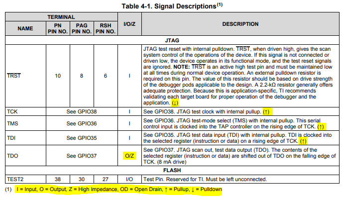

Is there internal pullup or pulldown on GPIO34 and/or GPIO37 (TDO) on reset (at the time that these boot pins are sampled)?  Are external pulls required?
In the Datasheet, based on what I read in section 4.2, it would seem that both pins would have internal pullups.  However, based on Table 4.1, it would seem that GPIO37 (TDO), at least, has no internal pullup or pulldown.

  • Whether or not to have an external PU is up to the application. The internal PUs are weak, as the datasheet numbers show. If an application chooses an external PU to augment the internal PU, the value of the external resistor must be chosen in a way that the MCU (or external circuitry) is able to drive a low-level on that pin comfortably. In the latter case, the VIH/VIL levels should not be violated.
    I am double-checking with the Design team, but according to the spec, it does appear TDO pin has an internal PU.
  • I confirmed that TDO does have an internal PU.
