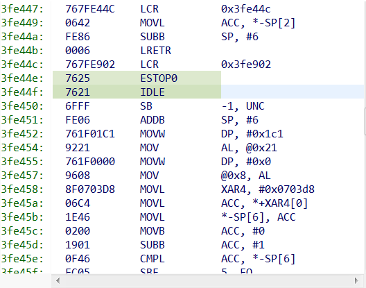

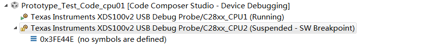

When I flashed to TMS320F28377D,  CCS  reports the following error:
C28xx_CPU2: Trouble Setting Breakpoint with the Action "Remain Halted" at 0xc056: (Error -1066 @ 0xC056) Unable to set/clear requested breakpoint. Verify that the breakpoint address is in valid memory. (Emulation package 7.0.100.0)
CCS can connect to the DSP, but CPU2 will atuo run while the program is loaded. But it will stop at 0x3FE44E. It is the wait points for CPU2. And the CCS debug viewer display there is a SW breakpionts make CPU2 stops, But I never add the SW breakpoints into the program. And the program can be run well in the demo board, and CPU2 works well. please give some adivce.
