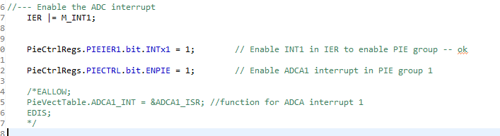

Im referring the workshop LAB 6 code in that Im not able to configure Interrupt code , I have done some changes but not getting output ..
Any Reasons ??
  • Saurabh,
    To enable ADC-A interrupt 1.1 try:
    //--- Enable the ADC interrupt
    PieCtrlRegs.PIEIER1.bit.INTx1 = 1; // Enable ADCA1 interrupt in PIE group 1
    IER |= 0x0001; // Enable INT1 in IER to enable PIE group
    You don't need to enable the PIE (ENPIE) since this is already done in the PieCtrl.c file. Also, remove your IER |= M_INT1;
