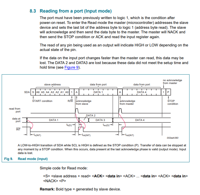

Hi, I'm trying to communicate an TMS-F28377S with a LCD display (PCF8574).  I'm not getting to use i2C communicate
I'm use the code example  "Example_2837xDI2C_eeprom.c">
I want sent a data to bus, but  I couldn't identify on the code where I should put a data
in while(1), this code send data to bus, and a can see on the oscilloscope.
But I don't no where change a *msg variable

  • Thanks Kevin Allen for reply
    I try change somethings
    I made some changes.
    struct I2CMSG I2cMsgOut1={ I2C_MSGSTAT_SEND_WITHSTOP,
                               I2C_SLAVE_ADDR,
                               I2C_NUMBYTES,
                               0x00};
    if I remove this code, the communication stops:
    I2caRegs.I2CDXR.all = msg->MemoryHighAddr;
    I2caRegs.I2CDXR.all = msg->MemoryLowAddr;
    something are being sent to bus, because if i make this code, the LCD backlight turn on and turn off, according DELAY_US frequency and some
    characters are shown on the LCD.

    something are sent to Display, but i'm not sure what is wrong. OR if mistake is on i2C data sent or is wrong display data config
  • according  I2C slave datasheet (https://www.nxp.com/docs/en/data-sheet/PCF8574_PCF8574A.pdf,
    I need send 8bits to config LCD_DISPLAY, but i'm confused in what data port I need write
  • I found this code, but i'm not sure how modify for a F28379D ( gist.github.com/.../5704409 )

  • Hi Tiago,
    I'm happy to hear that you were able to get this working and thank you for sharing your code/solution.
    You said that removing the High/Low address portions from the write_data function makes the communication not work? That seems odd, since the high/low address attributes of the I2C_message structure aren't defined, but maybe there's a good explanation for that (i.e. need to write bytes of zeros or something before sending data).
    Maybe looking at the waveforms would help explain this as well, if you're wanting a better understanding. Either way at least you got something working =).
    Kevin
