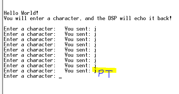

I am using the echoback.c program of TI C2000. I would like to send more than one character (as in picture attached, jpt for example) over the Hyperterminal (or Putty).
I was going through the forum, but I missed myself among too much other infos. Can you please guide me further?
which example of C2000 works the best in my case?

  • Hi Devin,
    the "Hello world" is a fixed message, that in the loop of function scia_msg() is transmitting character by character.
    I like to transfer more than one character via the PC keyboard, observing them in Hyperterminal (in echoback as I enter one letter it goes to a new line , actually I can enter only one letter).
    Indeed, I need to send one value like 0x0AFF to my program, I should be able to write the value e.g. 0x0AFF via my PC keyboard ( for controlling it see it in Hyperterminal), then set it
    // scia_xmit - Transmit a character from the SCI %%✏ i need to transfer more than one character. e.g. 0x0AFF.

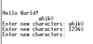

  • Hi Devin,
    thanks for fast reply.
    I changed the code as following:

    "I'm not sure if you want to always send as hex, or if this is supposed to be an option"? I need to send Hex value in my final program.
    the Hperterminal buad rate is 9600. Just now for testing the code, I am sending four character, after 4 character I receive non-sense character.
    I should add, when I put the buffer size equals an odd number. e.g. 3, there is no problem.
    thank you in advanced.
    Parisa
  • Hi Parisa,
