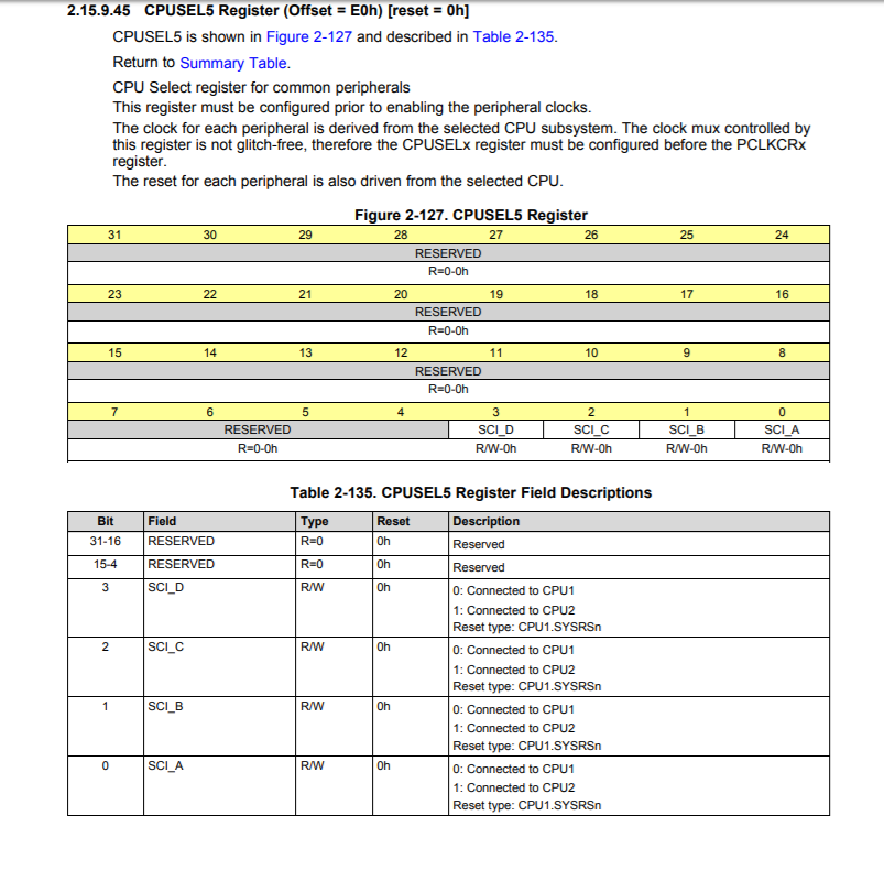

  • I know what your problem is :)
    You need to assign your PERIPHERAL to CPU2.
       //ASSIGN SCIx to CPU2
       DevCfgRegs.CPUSEL5.bit.SCI_A = 1;
       DevCfgRegs.CPUSEL5.bit.SCI_B = 1;
       DevCfgRegs.CPUSEL5.bit.SCI_C = 1;
       DevCfgRegs.CPUSEL5.bit.SCI_D = 1;
    After this CPU1 can no longer access SCIx. So you can do this before or after you configure the SCI control registers.
    The section of the TRM for these regs are:
    Good luck with the rest of your development.
    Nima Eskandari

  • Third comment I have is , you need to write to the DEVCFG regs to assign the peripheral to the different cores. In driverlib we have a function for this. I think It is a possibility that the EALLOW protection didnt let you configure the DEVCFGs.
    static inline void
    SysCtl_selectCPUForPeripheral(SysCtl_CPUSelPeripheral peripheral,
                                  uint16_t peripheralInst, SysCtl_CPUSel cpuInst)
        uint32_t tempValue;
        uint16_t shift;
        if(SYSCTL_CPUSEL14_DAC == peripheral)
            shift = peripheralInst + SYSCTL_CPUSEL_DAC_S - 1U;
        else
            shift = peripheralInst - 1U;
        tempValue =
            HWREG(DEVCFG_BASE + SYSCTL_O_CPUSEL0 + ((uint32_t)peripheral * 2U)) &
            (~((uint32_t)1U << shift));
        EALLOW;
        HWREG(DEVCFG_BASE + SYSCTL_O_CPUSEL0 + ((uint32_t)peripheral * 2U)) =
            tempValue | ((uint32_t)cpuInst << shift);
        EDIS;
    So maybe this is the problem:
    EALLOW;
    EDIS;
  • One last thing before I test on my HW. I do not see any comment mentioning the range for SCIB, can you point it out?

  • Here is your final solutions.
    1. Calling the following functions,
       GPIO_SetupPinMux(70, GPIO_MUX_CPU2, 6);
       GPIO_SetupPinOptions(70, GPIO_INPUT, GPIO_PUSHPULL);
       GPIO_SetupPinMux(71, GPIO_MUX_CPU2, 6);
       GPIO_SetupPinOptions(71, GPIO_OUTPUT, GPIO_ASYNC);
    does NOT block SCIB to write to the pins. These functions ONLY BLOCK GPIO accesses. Ex. writes to GPIODAT GPIOSET GPIOCLEAR , ... are blocked
    2. What will block CPU1 access to SCIB and the pins? the following line does it.
       EALLOW;
       EDIS;
    This was tested on my hardware.
