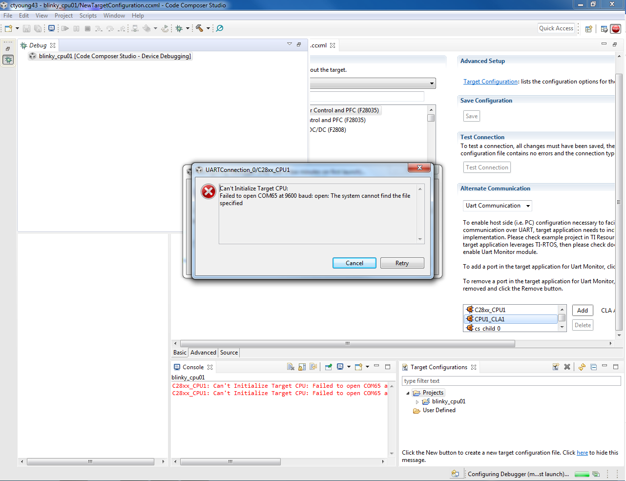

  • trying to load an example in through ccs I'm getting this.

  • Sam,
    Why have you chosen "Uart Communication" in Alternate communication option?
    Manoj
  • Not sure what you mean but I have tried it when the uart communication is blank also
  • It looks like a hardware issue. Is this the only board you have this problem?
    -Manoj
  • I'm not sure only tried one other board.
  • Sam,
    It is not CCS issue. I'm not sure what support TI can provide as it looks like a hardware issue.
    Manoj
