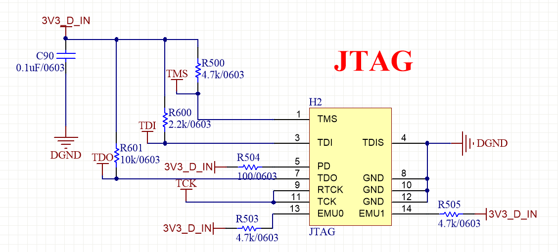

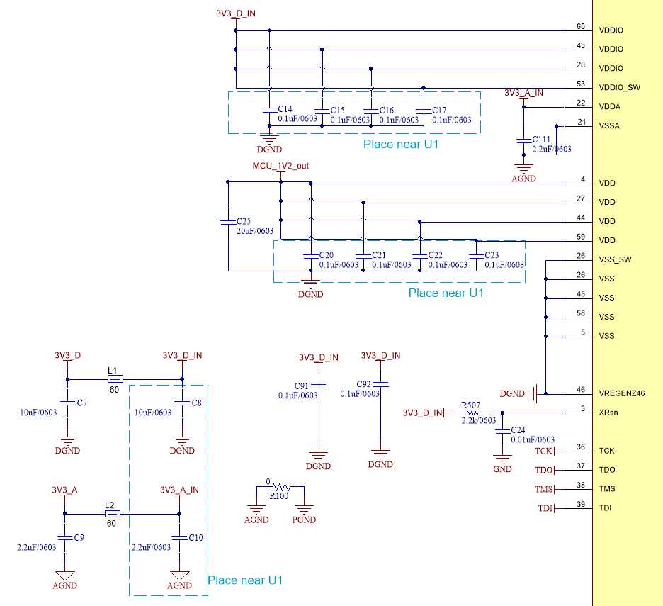

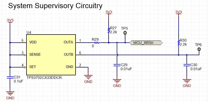

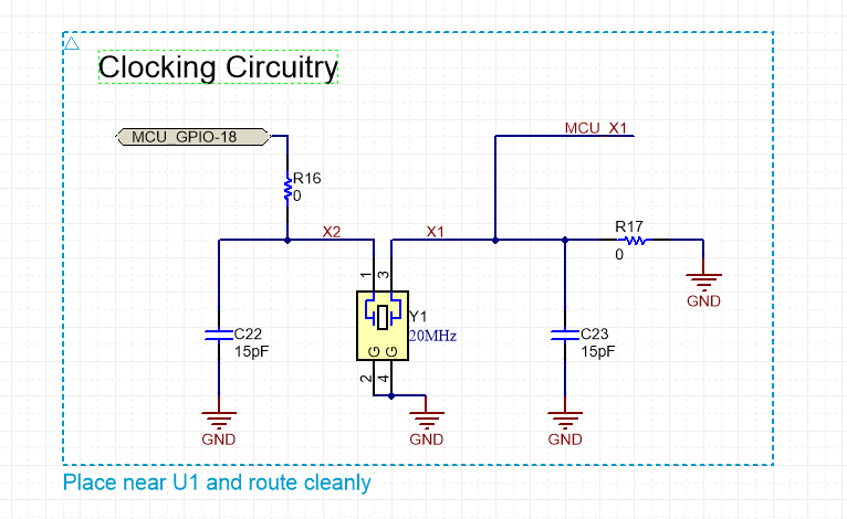

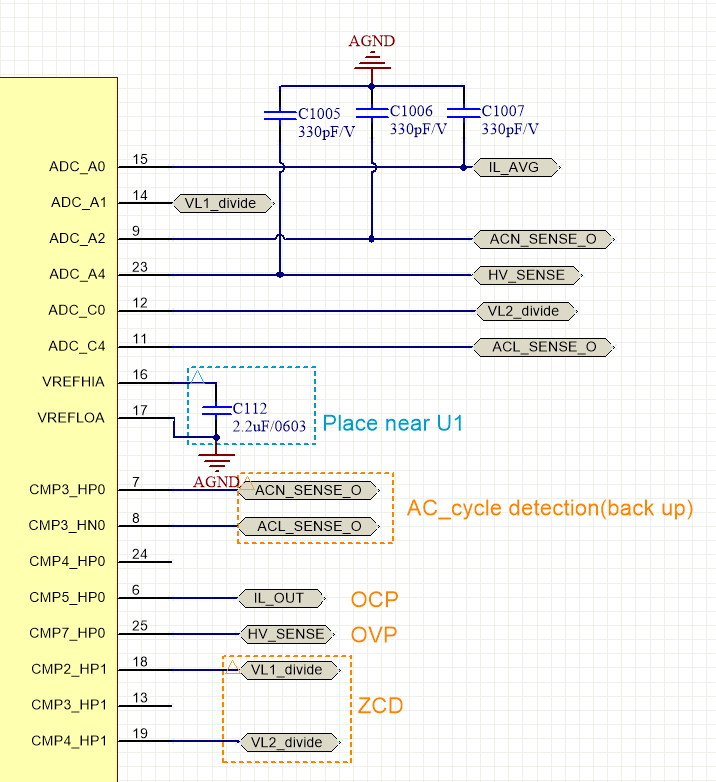

Hello
I work with TMSF280049cpms on custom board, 64pin.
I can’t measure the PWM signal on GPIO PIN what I setting, but the same code use in The Piccolo F280049 control CARD with 120HSEC connector, I can measure the PWM signal what I setting.
So I guess my custom board have design problem, I have referring to the The Piccolo F280049 control CARD of the layout.
Can you help me to find any problem of my custom board design?
