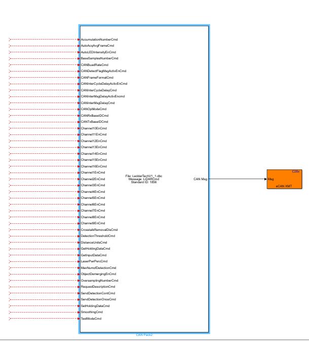

I'm trying to use the CAN dbc file and multiplexing technique in Simulink but the block doesn't seem to allow me to choose the multiplexor value and pick the appropriate signals accordingly.
When I select the message, all the related signals are selected and the multipexor value is grayed out:
Has anybody tried using multiplexing with Simulink?

  • Brian,
    Thanks for your message.

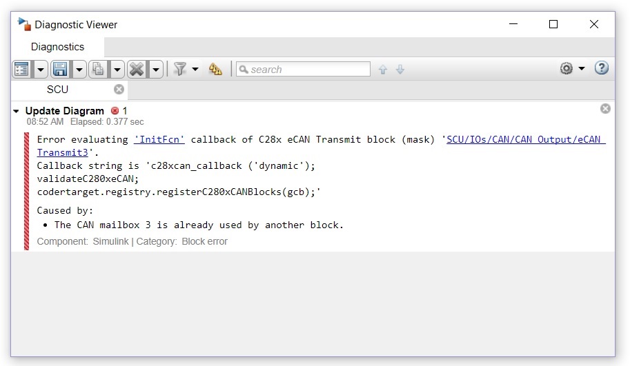

    I contacted MathWorks Tech Support and it turned out that it's not possible to select only a group of signal associated with a particular multiplexed value, when the dbc file is uploaded, all the signals and messages are populated regardless of the multiplexed values. I was recommended to manually specify the signals within the CAN Pack block, but again the old issue will arise where we cannot use multiple eCAN XMT blocks with the same Mailbox number. But the purpose of multiplexing is to use a single message ID for multiple messages!
    I tried different approaches but wasn't successful. Please see the error I get during compile:
    This is my simple model:
    These are the settings of the eCAN XMT block:
    And this is the error that I get:

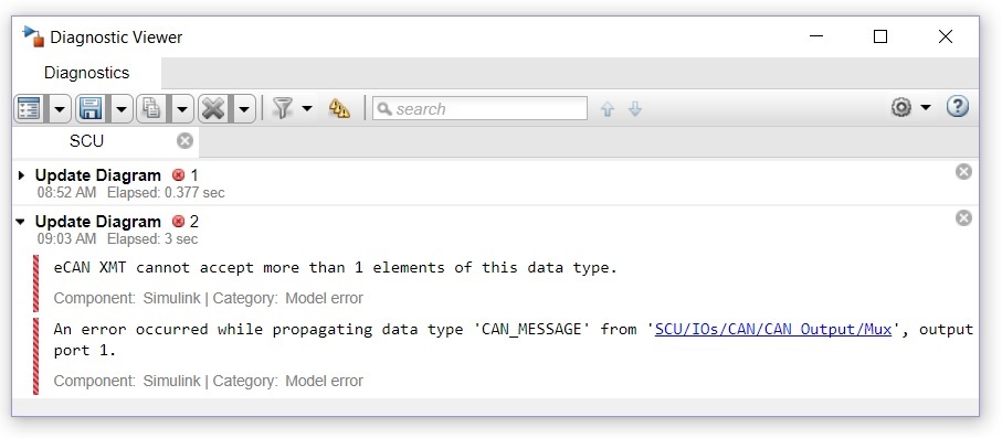

     I even tried to use Mux to combine the messages but I get another error:
    Is there anyway to overcome this issue? (using one eCAN XMT block for multiplexed signals).
  • Hi Khashayar,
    I haven't tried the below proposal for myself, but I think this is something we can give a try.
    Inside the CAN Tx interrupt subsystem, based on a condition, we can call the memory copy block to update the Message ID of the given mailbox.
    Hopefully the same condition will also take care of which signals are routed to CAN Tx block at that instance.
    That way we can have 1 CAN Tx block pre-configured for a given Mailbox and message ID, but during run time we can write to CAN registers to update the message ID.
  • Venkatesh,
    Thanks for your help.
    That does sound reasonable to me. I'll give it a try but for now, I'm using a simple multi port switch in Simulink that changes the input port every 100 msec using a timer.
    Will update you when I test your solution.
