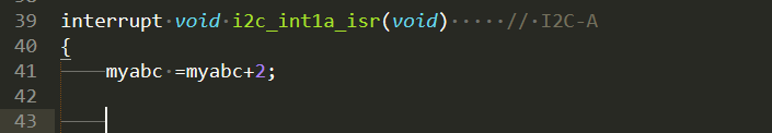

Hi guys, I'm trying to use my C2000 launchpad featuring a TMS320F28027 as an I2C slave. My interrupt routine never seems to be triggered.I created a global variable that is supposed to be incremented by 2 every time I go in the routine. I look at the variable using the  By looking to my code I do not find what could possibly be wrong.
Does anyone have an idea?
Thank you guys !

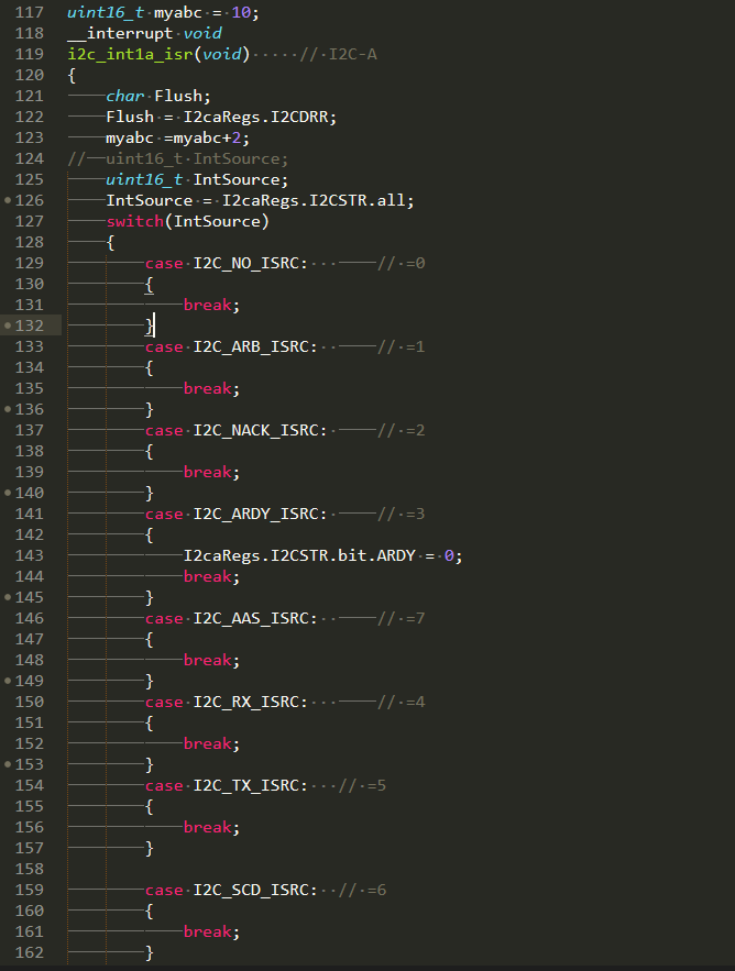

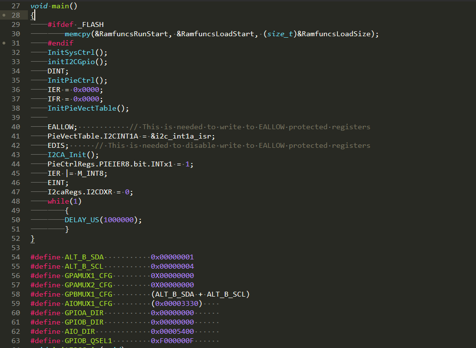

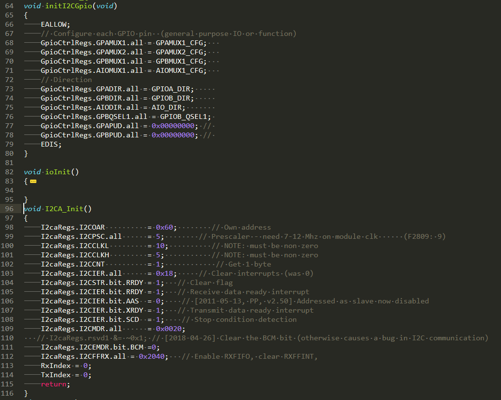

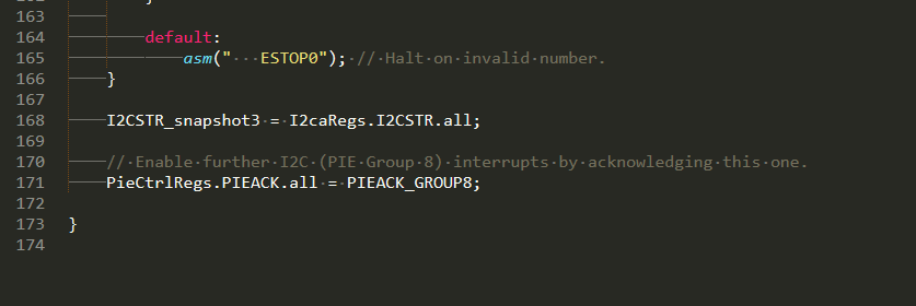

  • Hi Sir, so I modified a little bit my code.Below is the new version.
    My tests are still not working.. I put a breakpoint in the ISR but I never seem to go into it. I added capacitors of 47pF. I thought this might help but still nothing..

  • Hi Amine,
    Please follow Manoj's GPIO configuration exactly except with the following change:
    GpioCtrlRegs.GPBQSEL1.bit.GPIO32 = 3;     // Set to 3 for async
    GpioCtrlRegs.GPBQSEL1.bit.GPIO33 = 3;
    If that doesn't fix the issue please try turning on FREE mode within your I2C init function:
    I2caRegs.I2CMDR.bit.FREE = 1;
