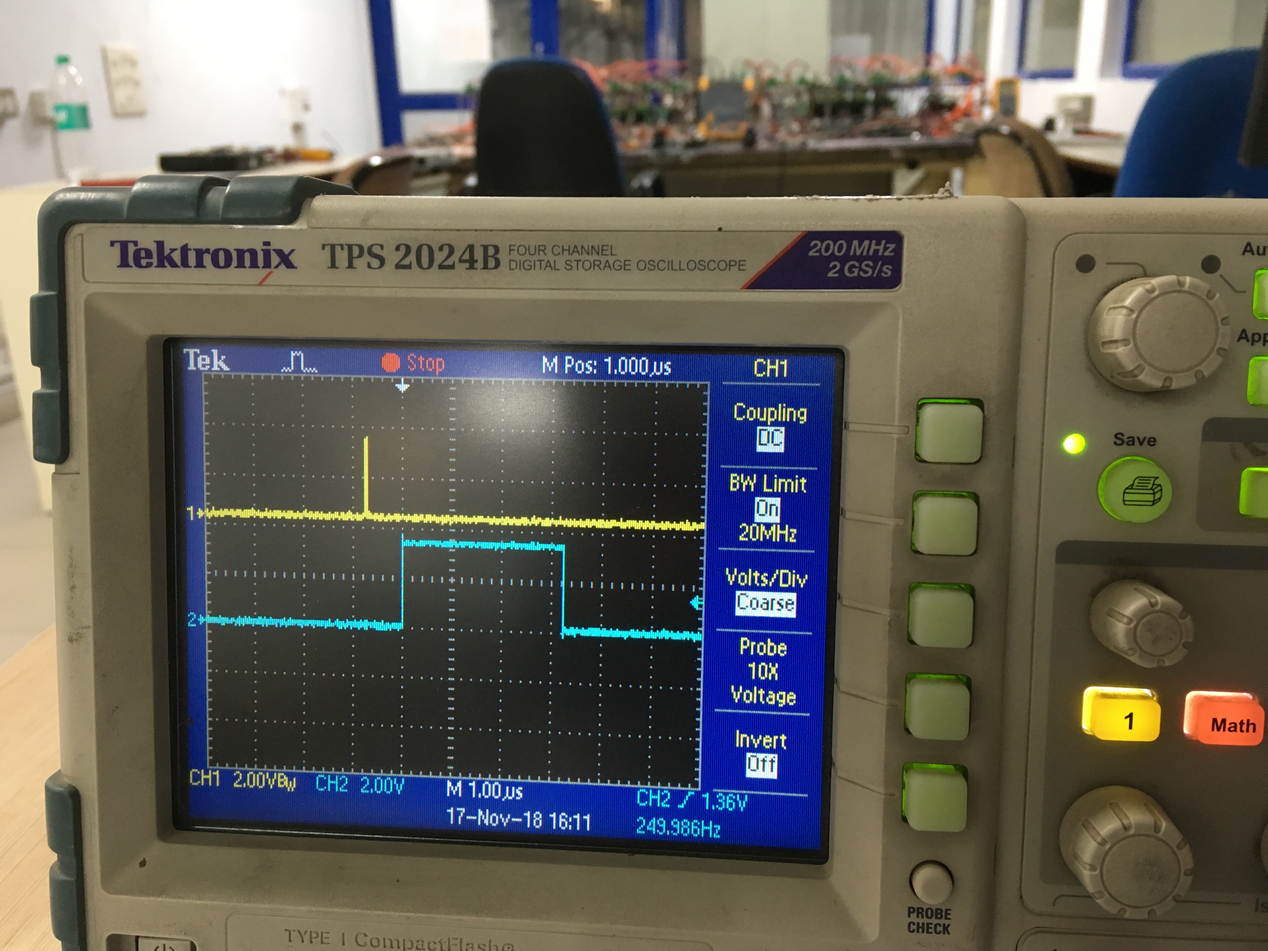

As per the specification, the SYNCOUT pulse which comes from XBAR OUTPUT to sync other MCU's PWM is 20nSec(Four Clock Cycle). But is it possible that the pulse with can be increased? 20nS is very short duration to sending the signal from one MCU to other MCU without a very precise hardware circuit.
My Issue may be resolved if I can able to increase the pulse width of XBARSYNCOUT.
It is really appreciated if someone has a solution about this. If there are any references please give me the link.

  • By doing all these things my ultimate aim is to synchronize all MCU PWM.

  • Well the answer is no you cannot STRETCH the EXTSYNCOUT signal.
    But what you CAN do is instead of selecting EXTSYNCOUT on the PINMUX, select an OUTPUTXBAR which is sourced from EXTSYNCOUT.
    Then enable the LATCH on OUTPUTXBAR, and manually clear the latch whenever you feel like you have a long enough signal.

  • Here I already enable the latch, but do you mean I need to force the latch in it?
    XBAR_enableOutputMux(XBAR_OUTPUT1,XBAR_MUX14);
    XBAR_setOutputLatchMode(XBAR_OUTPUT1,true);
    XBAR_setOutputMuxConfig(XBAR_OUTPUT1,XBAR_OUT_MUX14_EXTSYNCOUT);
    I have done the above configuration and I got 20nSec pulse only.
    Ashutosh
  • The figure below shows what I shared. This should take care of your need. The latch is there keep the signal until you CLEAR it.

     * Setup Output X bar EXTSYNC GPIO
        GPIO_setPadConfig(6, GPIO_PIN_TYPE_STD);
        GPIO_setPinConfig(GPIO_6_EPWMSYNCO);
        GPIO_setPadConfig(7, GPIO_PIN_TYPE_STD);
        GPIO_setPinConfig(GPIO_7_GPIO7);
        GPIO_setDirectionMode(7, GPIO_DIR_MODE_OUT);
        GPIO_writePin(7, 0);
        XBAR_disableOutputMux(XBAR_OUTPUT1,XBAR_MUX14);
        XBAR_setOutputMuxConfig(XBAR_OUTPUT1, XBAR_OUT_MUX14_EXTSYNCOUT);
        XBAR_setOutputLatchMode(XBAR_OUTPUT1, true);
    //    XBAR_getOutputLatchStatus(XBAR_OUTPUT1);
    //    XBAR_clearOutputLatch(XBAR_OUTPUT1);
        // Disable sync(Freeze clock to PWM as well)
        SysCtl_disablePeripheral(SYSCTL_PERIPH_CLK_TBCLKSYNC);
        initEPWM1();
        initEPWM2();
        initEPWM3();
        // Enable sync and clock to PWM
        SysCtl_enablePeripheral(SYSCTL_PERIPH_CLK_TBCLKSYNC);
        // Enable ePWM interrupts
        Interrupt_enable(INT_EPWM1);
        Interrupt_enable(INT_EPWM2);
        Interrupt_enable(INT_EPWM3);
        // Enable Global Interrupt (INTM) and realtime interrupt (DBGM)
        EINT;
        ERTM;
        // IDLE loop. Just sit and loop forever (optional):
        for(;;)
            NOP;
            if(XBAR_getOutputLatchStatus(XBAR_OUTPUT1)==true){
                GPIO_writePin(7, 1);
               if(++Timer_latch>=5){
                  Timer_latch=0;

     Hi Nima,
    By using your suggestion as above, I have changed one of the codes given by TI C2000 ware. I am sharing you the wave form and the code What I changed.
    First I found the latch status and when I got the latch state high I make a GPIO high and as per my requirement I did the pulse down and clear the latch but here I got one issue which you can also figure out from the CRO waveform I sharing you. Both pulses have some delay around 500nS, is this acceptable for syncing the other MCU PWM?
    And still, my main issue is not resolved that I am unable to sync two MCU PWMs while stating the convert on power mode. Even if I send the signal through the optical wire.

  • Got it. Sending you the working code.
  • Using GPIO24 and GPIO0. GPIO24 is the EXTSYNCOUT.
    The variable "clearFlag" is set in the interrupt at CTR = ZRO. The main while loop clears the OUTPUTXBAR latch when needed. In my case I wanted the width to be approx 2us.
