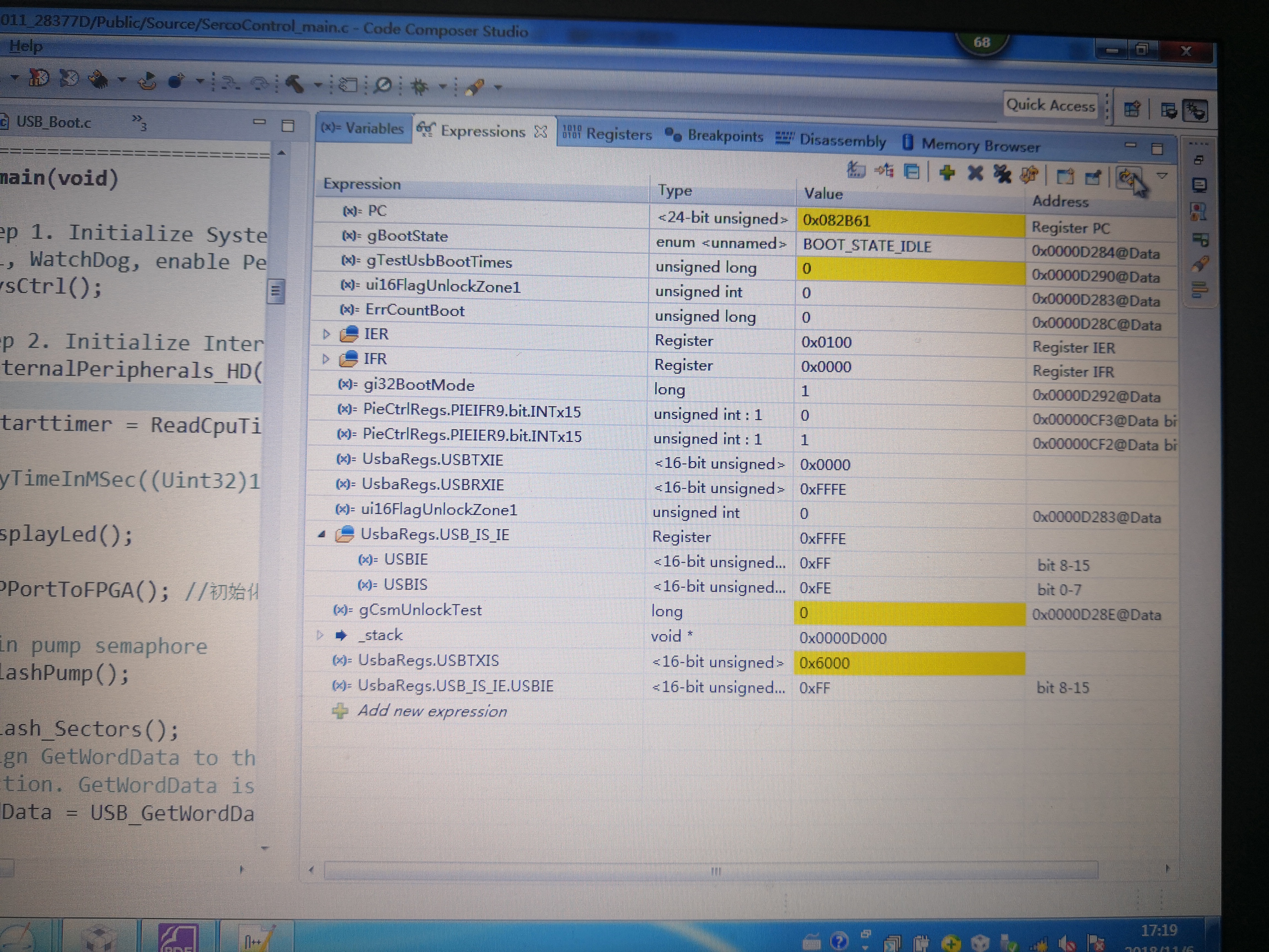

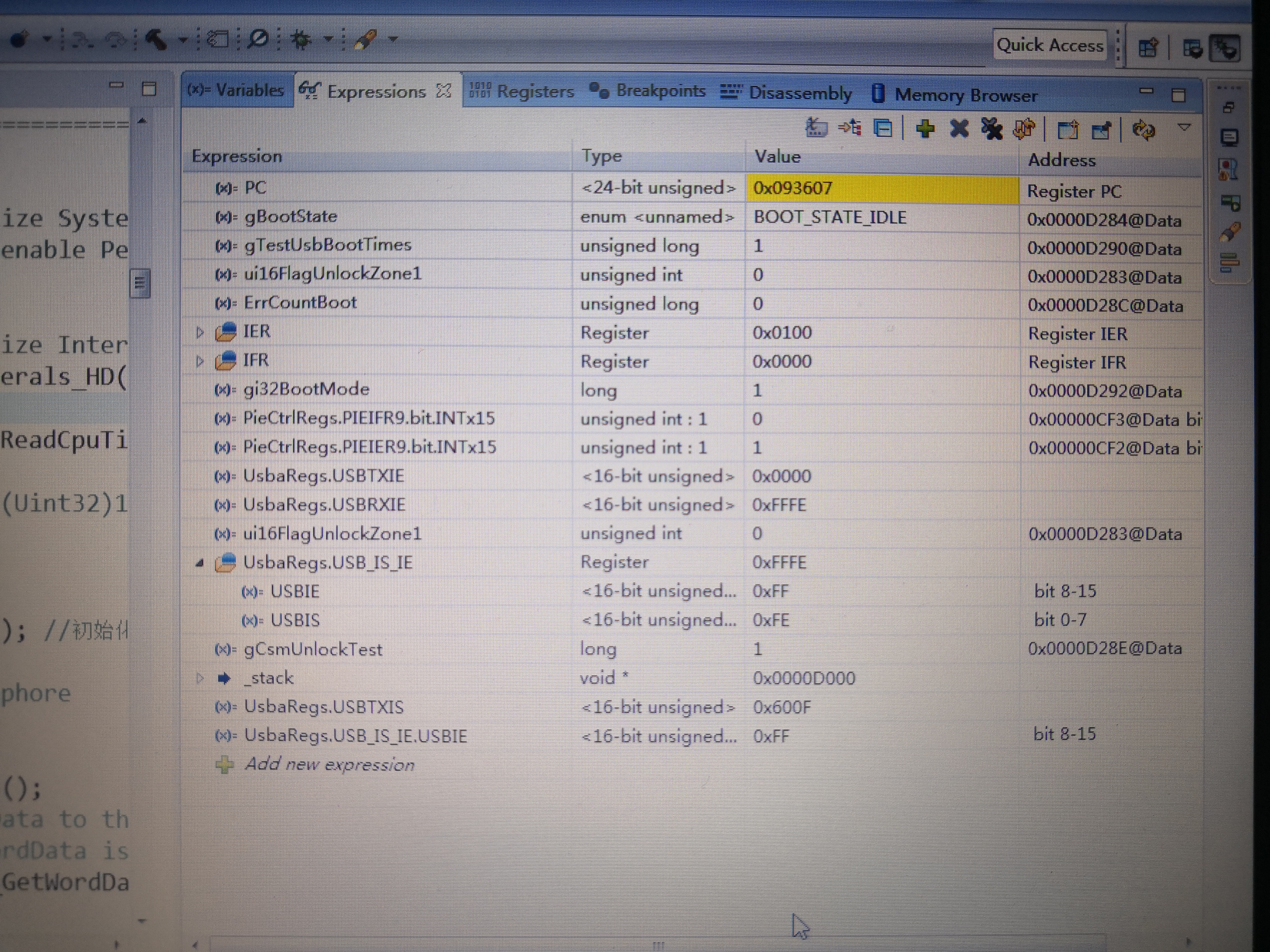

The problem is:
1) If we execute the bootloader after power up, everything goes well.
2) If we execute the bootloader by jumping from the app code. The USB cannot be recognized sometimes.

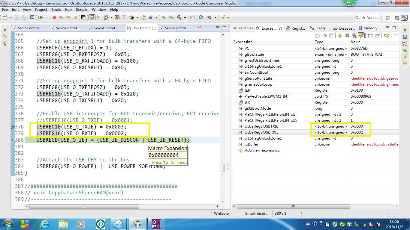

We cannot identify a certain condition when the failure happens. However, we have noticed the following wired things:
As you can see, we write 0x0003 and 0x0002 to USBTXIE and USBRXIE. However, if we execute a single step, the value of USBTXIE becomes 0x0000.
If the code is executed coutinously, USBRXIE is 0xFFFE, while USBTxIE is0x0000.

    We should have identify the problem with more detail, however, we have no idea how could this happen.
    So far, we noticed the following two weird things:
    1) The result read from USBRXIE and USBTXIE is not the value we wrote (mentioned above).
    2) The wrong PC state:
    As you can see in the .c file and disassembly window, after the BootLoadCsmUnlock() the next gCsmUnlockTest++ should be execute. However, sometimes, the PC will jump back to BootLoadCsmUnlock() and execute it again. Since no USB communication is received, the program is stucked in the function. Do you have any idea how could this happen?
    3) If we jump into bootloader from app, the USB cannot be recognized even if we re-plug the USB cable.

    	//Enable USB interrupts for EP0 transmit/receive, EP1 receive, disconnection, and reset
    	//USBREG16(USB_O_TXIE) = 0x0001;
    	USBREG16(USB_O_TXIE) = 0x0003;
    	USBREG16(USB_O_RXIE) = 0x0002;
    	USBREG8(USB_O_IE) = (USB_IE_DISCON | USB_IE_RESET);

    USB_Init();
          //EnableInterrupts();
          USBDevDisconnect(USB0_BASE);
          USBDevConnect(USB0_BASE);
          IntMasterEnable();
    USB_Init is included in the above code. USBDevDisconnect() USBDevConnect() is from USB.c. While IntMasterEnable() is from interrupt.c
    According to our knowledge, we cannot understand the connection between this 3 problem. We are really looking forward to your reply.

    As you mentioned, we also believe some interrupt is not getting cleared so the new interrupt cannot be  acknowledged.
    So we try to follow the corresponding registers in the watch window.
    Before we refresh the watch window, the state is attached as following. And the USB cannot be recognized:
    If we refresh the watch window, the picture shows the new state. And USB can be recognized this time.
    According to my knowledge, I cannot figure out why refreshing the watch window may influence the running MCU. And I cannot see any key register changed. In our code, only EP0 and EP1 is intialized, why the state of USBTXIS is 0x600F? And as you can see, the state of USBTXIE and USBTXIE are still not the value we wrote.
    If I remember correctly, reading from the IS registers, even from the debugger, will clear those registers. Unfortunately, this is an issue with the silicon. Debugger reads clear the interrupt status registers. So, it is best not to have expression windows, register windows or memory browsers reading from those register values.
    We have one other user on E2E which says the registers are changing unexpectedly. I am not familiar with this behavior.
    Can you set some breakpoints in the code and narrow down where the registers are changing. Can you determine what is causing the change to the registers?
