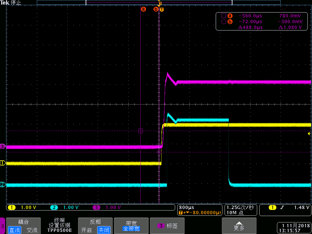

Dear all,
We found the GPIO0 output 2ms glitch during power on, here is the scope:
CH1 is 1.9V, CH2 is GPIO0, CH3 is 3.3V

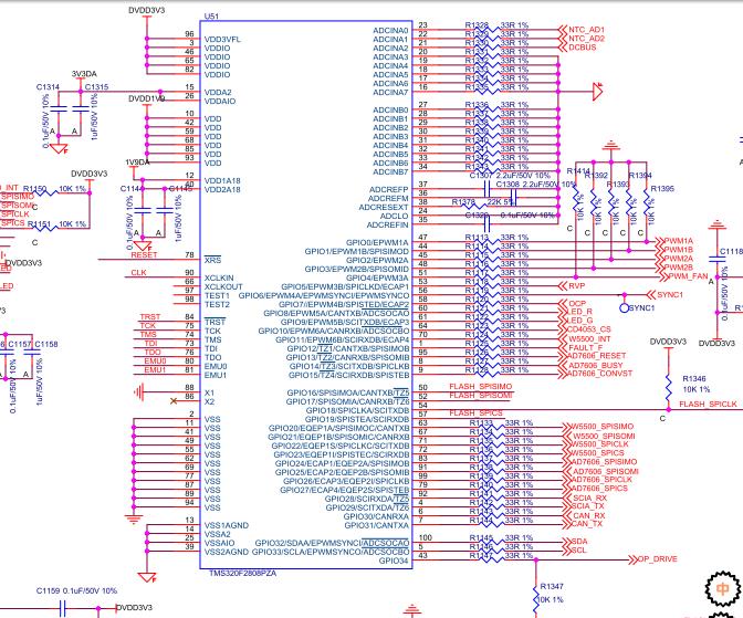

Here is my SCH:
Do you have any suggest?
Thanks.
