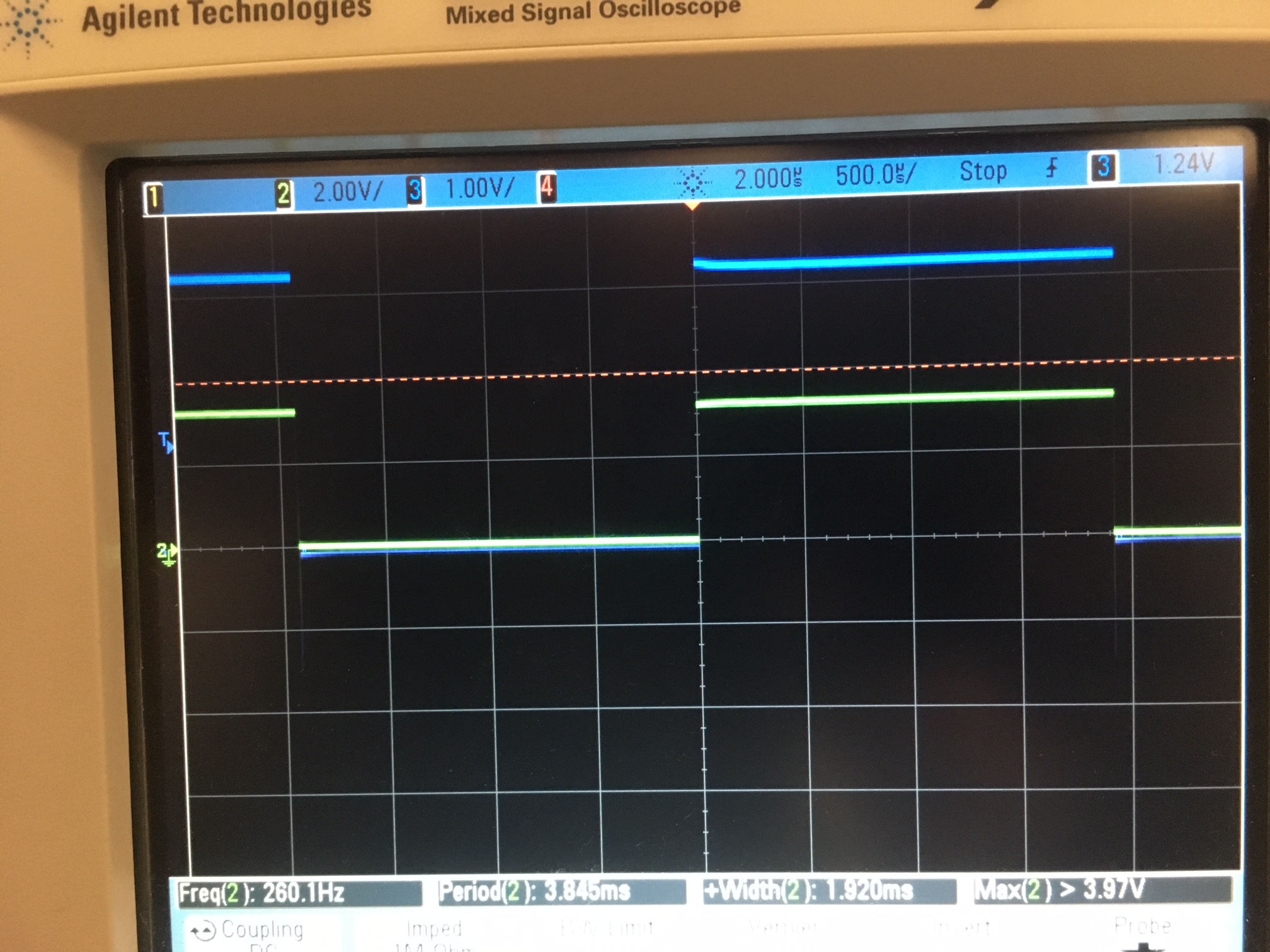

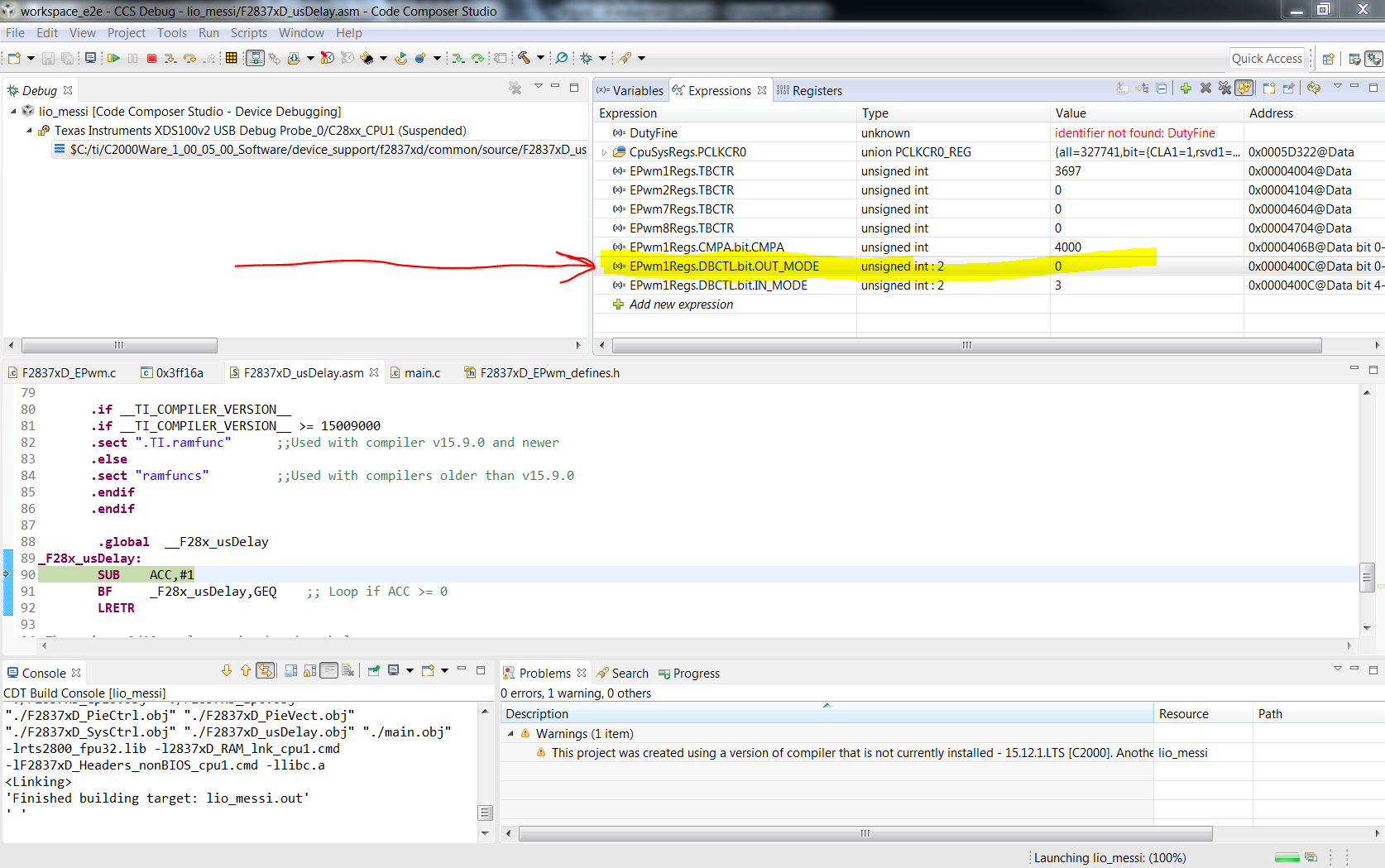

    Okay so here is how to test and verify this,
    load and run the code. Then add the following register to watch window,
    Set the register to 0. Make sure the write takes effect by doing a single step and verifying the new value.
    Run.  The following screen shot from the scope show the DB disabled. As you can see, the OUTPUT A and OUTPUT B of ePWM1 are the exact same. No deadband.

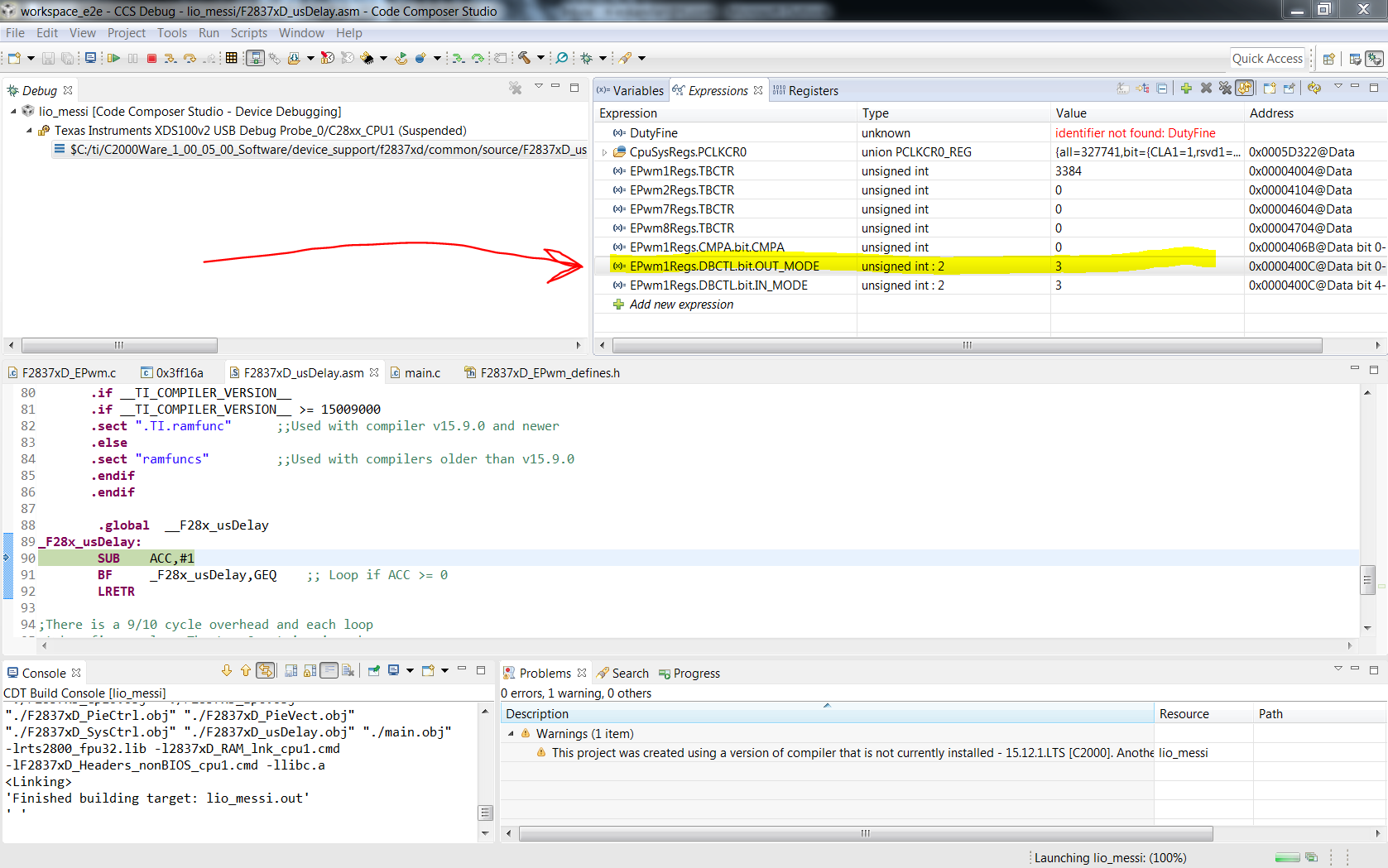

    Halt, change the value to 3.
    Now on the scope you will see that the DB has taken effect and delays have been added.
