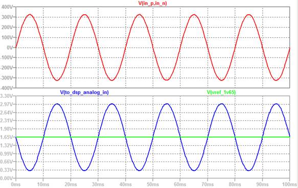

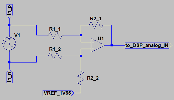

    This is how wo are doing ADC on AC signals today:

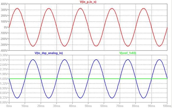

    This results in a signal centered around 1.65V, with an amplitude of 1.65V (here for 400V AC):

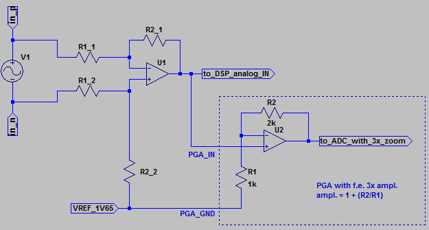

    If we want to use the PGA and switch the amplification DYNAMICALLY to adjust the fullscale range, we would like to keep our offset of 1.65V and
    Zoom to 133Vpk with PGA ampl. equal to 3
    Zoom to 66Vpk with PGA ampl. equal to 6
    Zoom to 33Vpk with PGA ampl. equal to 12
    This would be possible if the PGA GND_REF could be at 1.65V:
    Without this, we have to change our external OP offset together with the PGA gain.
    We can't remove the DC offset completely via capacitor because we have to detect DC offset in the signal.
    Do you agree that all this makes the use of the PGA for AC signals hard ?
    Because of this I proposed a GND_REF of up to 1.65V for a future device...
    Regards, Stephan

    4.(AC+DC) signals for which you care about both. For these types of signals, from the PGAs perspective, I don't think of them as a AC signal with a DC offset but rather a complete signal. I believe this is where your use-case falls into.
    For this, you'll have to divide down your whole signal with resistors if it's not in the valid PGA range before gaining by the PGA since you care about both. Have you considered this?
    Not sure how much leeway you have in your application but another option will be to measure the AC and DC separately. Use a capacitor to remove the DC and use an inductor to remove the AC and measure the 2 signals on 2 channels.
    Nevertheless, we currently don't think this is a typical use-case but that could obviously change as the PGA has had time to mature in the market. If that assumption ends up not holding anymore, we will explore removing the PGA_GND restriction on a future PGA.
    On the question of why the restriction on PGA_GND: This is because of how some of the internal structures are designed. The diagram in the TRM is a functional diagram and not necessarily how the PGA is implemented. There is of course nothing that physically prevents you from doing that but since it would fall under the umbrella of using the PGA out of specification, non of the specifications in the datasheet will apply.
    One parting question: From one of your screen captures, "to_dsp_analog_in" is shown as full-scale, going from about 0.33V to 2.97V. If your signal is already full-scale, why do you need to go through the PGA? Is this just for buffering.
  • Hi Frank,
    regarding your last question:
    The screen capture shows our actual design, with max. "to_dsp_analog_in" from 0 to 3.3V.
    But this signal can vary and can also be a lot smaller - this is where we would like to use the PGA to do not loose resolution as we do now.
