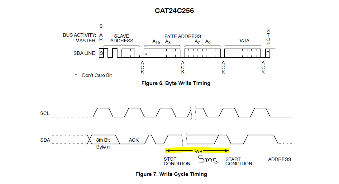

       I  have reduced my code to do a single byte read and write.
    I2CMasterSlaveAddrSet(I2C0_MASTER_BASE, SLAVE_ADDRESS, false);
    ulDataTx[0] = 0x00;
    ulDataTx[1] = 0xff;
    ulDataTx[2] = 0x03;
    I2CMasterDataPut(I2C0_MASTER_BASE, ulDataTx[0]);
    I2CMasterControl(I2C0_MASTER_BASE, I2C_MASTER_CMD_BURST_SEND_START);
    while(I2CMasterBusy(I2C0_MASTER_BASE)){}
    I2CMasterDataPut(I2C0_MASTER_BASE, ulDataTx[1]);
    I2CMasterControl(I2C0_MASTER_BASE, I2C_MASTER_CMD_BURST_SEND_CONT);
    I2CMasterDataPut(I2C0_MASTER_BASE, ulDataTx[2]);
    I2CMasterControl(I2C0_MASTER_BASE, I2C_MASTER_CMD_BURST_SEND_FINISH);
    unsigned long wait =0;
    for(wait =0; wait <= 50000; wait++);
    //Read byte
    // Initialize the receive buffer.
    for(ulindex = 0; ulindex < NUM_I2C_DATA; ulindex++)
    ulDataRx[ulindex] = 0;
    I2CMasterSlaveAddrSet(I2C0_MASTER_BASE, SLAVE_ADDRESS, I2C_WRITE);
    // Dummy Write to set the future read address
    I2CMasterDataPut(I2C0_MASTER_BASE, 0); // address zero in the EEPROM memory
    I2CWhileMasterBusy
    I2CMasterDataPut(I2C0_MASTER_BASE, 0XFF); // address zero in the EEPROM memory
    I2CWhileMasterBusy
    // Start reading the address 0x00
    I2CMasterSlaveAddrSet(I2C0_MASTER_BASE, SLAVE_ADDRESS, I2C_READ);
    I2CMasterControl(I2C0_MASTER_BASE, I2C_MASTER_CMD_SINGLE_RECEIVE);
    I2CWhileMasterBusy
    ulDataRx[0] = I2CMasterDataGet(I2C0_MASTER_BASE);
    From the datasheet of EEPROM, the write cycle time is found to be 5ms. Please find the attachment. I am reading 0xff in any case.
  • Anoja,
    If you are trying to write 0x3 to EEPROM address 0x0. Then you need to follow these steps:-
    I2CWrite
    1) Configure I2C slave address of EEPROM into I2CSAR register
    2) Configure I2C and I2CFIFO to enable TX FIFO.
    3) Set I2CCNT = 3
    4) Write I2CDXR = 0 (A15-A8)
    5) Write I2CDXR = 0 (A7-A0) <-- Writing EEPROM address 0
    6) Write I2CDXR = 3 <-- Writing to data 3 to EEPROM (This will fill the TXFIFO)
    7) Send start bit, transmit and master mode. (I2caRegs.I2CMDR.all = 0x6E20)
    8) Wait for 5ms
    I2CRead
    3) Set I2CCNT = 2
    6) Send start bit, transmit and master mode (I2caRegs.I2CMDR.all = 0x2620)
    7) Set I2CCNT = 1
    8) Send start bit, receive and master mode (I2caRegs.I2CMDR.all = 0x2C20)
    Manoj

  • Anoja,
    There is a clear flowchart explained in TRM. Please check Figure23-10. Master Receive with repeated start.
    Manoj
  • Flow chart helped. Thank you.
