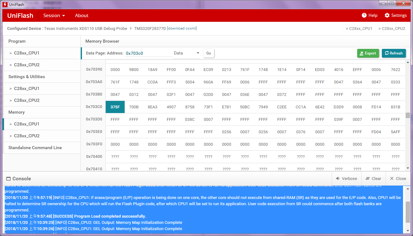

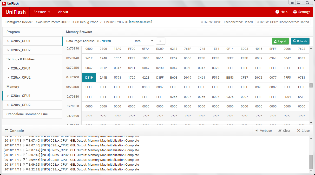

  • Whitney,
    I have gotten memory dump as below picture from customer:
    uint16_t UID_Data1[]={0x375F ,0x700B ,0x8EA3 ,0x4907 ,0x8758 ,0x73F1 ,0xE781 ,0x50BC ,0x7949 ,0xC2EE ,0xCC1A ,0x6E42 ,0xD3D9 ,0x0008 ,0xFD14 ,0x831B };
    uint16_t UID_Data2[]={0x700B ,0x375F ,0x4907 ,0x8EA3 ,0x73F1 ,0x8758 ,0x50BC ,0xE781 ,0xC2EE ,0x7949 ,0x6E42 ,0xCC1A ,0x0008 ,0xD3D9 ,0x831B ,0xFD14 };
    uint16_t UID_Data3[]={0xD319 ,0x5A4B ,0x5793 ,0x1729 ,0x6223 ,0xD3FF ,0xB608 ,0xD919 ,0xC461 ,0xF515 ,0xBB53 ,0xCF87 ,0xD9C3 ,0x0077 ,0x7FF5 ,0x97E1 };
    uint16_t UID_Data4[]={0x5A4B ,0xD319 ,0x1729 ,0x5793 ,0xD3FF ,0x6223 ,0xD919 ,0xB608 ,0xF515 ,0xC461 ,0xCF87 ,0xBB53 ,0x0077 ,0xD9C3 ,0x97E1 ,0x7FF5 };
    UID_CRC1       unsigned long  0x831BFD14 (Hex)
    UID_CRC2       unsigned long  0x223DFD14 (Hex)
    UID_CRC3       unsigned long  0xDF317FF5 (Hex)
    UID_CRC4       unsigned long  0x97E17FF5 (Hex)

  • Hi Simen,
    Checked the history of the checksum routines that are used for the UID and learned that both methods of calculation (little and big endian) are acceptable so both devices described above are good. For the F2837xD/2837xS/2807x family, the checksum for UID was initially done in little endian mode and has switched to using big endian at a later time. We will update the Technical Reference Manual that describes how the UID checksum is calculated.
    Sorry for the confusion.
    Joseph
