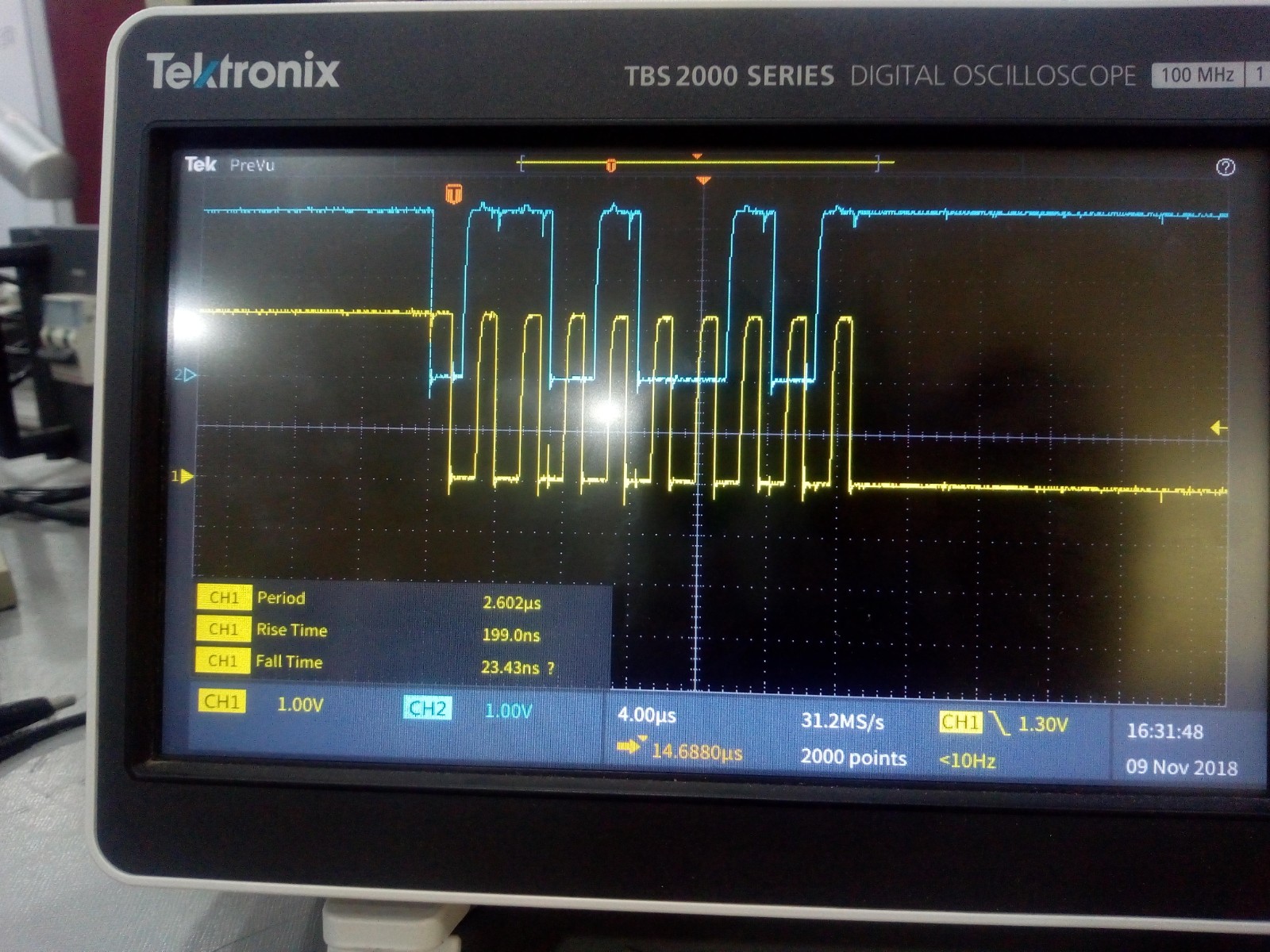

I have a problem with I2C module on the TMS320F28069. In particular my code generate the start condition, the address of the slave (are present on the SDA pin), but doesn't generate the data bytes!!!!!!
My code snippet is the follow:

this what am getting in the scope

  • Hi Arjun,
    Thank you for providing the waveform. The slave device doesn't seem to ACK the slave address, i.e. 9th bit is left high, and so the communication is stopped. The signal you provided is what's seen at the slave device, correct?
    What is your slave device? It looks like you set up the clocking to be 400KHz (fast mode), but maybe the slave device isn't compatible with fast mode and doesn't have clock stretching? If so, clocking SCL at 100KHz should work.

  • Hi  Kevin,
      I am using  MPU 6050  .
    The Slave  is compatible with fast mode, i tried  with the 100Khz ( Standard mode)  also  No change in the output .
    Programming Sequence is correct or any changes is required ?

  • Hi Arjun,
    Can you double check that the signal connections to the MPU 6050 are correct? Maybe SDA/SCL are going to the wrong pins. I assume you have tried both possible slave addresses already correct, 0x68 and 0x69?
    Does it make a difference if you write to the entire address in the write data function rather than each bit? (i.e. I2caRegs.I2CMDR.all = 0x6E20;)
    The only I2C driver currently available is that which is used in the i2c_eeprom example, which it looks like you're already referencing.
