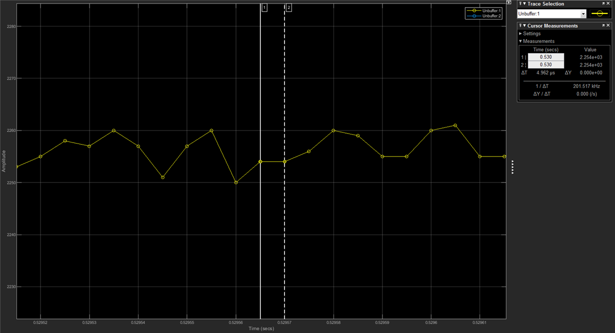

  • Hi David,
    I quickly got the 'f28377S_DCDC_Buck' demo model setup for F28379D and used the host read model 'c2000_host_read_F28379D' model to receive.
    Running out of CPU1 this model runs the control loop at 200KHz and send 2 uint16's at every 5usec. Which is like 2*200000 uint16's values every second.
    Serial communication usually sends 10 bits per data byte (1 start bit and 1 stop bit + 8 bits of data). At 200kHz, 2 uint16 data points mean 2x2x10x200000 = 8Mbps needed. We need make sure the target serial baudrate is set above this value.
    I have attached the models(both target and host) that worked for me, please can you try this at your end and see if you are successful?ti_forum.zip
  • Here is the image of scope that shows 2 uint16 captured every 5usec.
  • Thank you for the example code, but no with your code i can transfer 2 unsigned integer with a rate of just 100 kHz instead of 200 kHz.

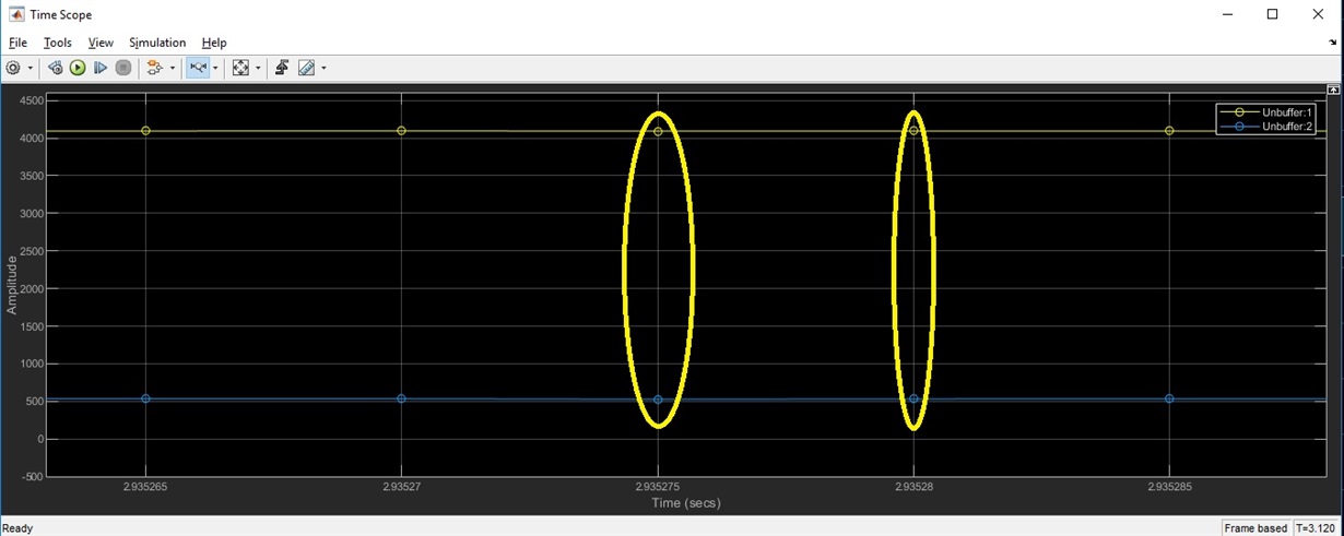

  • Hello Venkatesh,
    if I measure the transfer rate with the scope, I get the same transfer rate as you. But scope time is different from real world time, thats why I measure the transfer rate with the procedure described above and I get half of the transfer rate.
    Even with simout block I get the same result.
    In the attached image I have tout captured which is like I ran the simulation for 2.22 sec equal to 444001 number of 5usec.
    And for 5usec I have 2 samples of data. Please refer the attached image.
  • Thank you for the reply, but tout is simulation time.
    So, I get the same results as you, but as already mentioned before, simulation time is not equal to real world time.
    Thats why I check the data transfered over a specific time, measured with a stopwatch.
  • I am sorry, in this case simulink is able to get the data from target realtime as we have large buffer to collect the data on host side. Simulink reads the buffer only at 60ms rate hence the host machine pools data in buffer(12000 data points) and simulink reads this data 60ms rate. So there is no room for data drop there.
