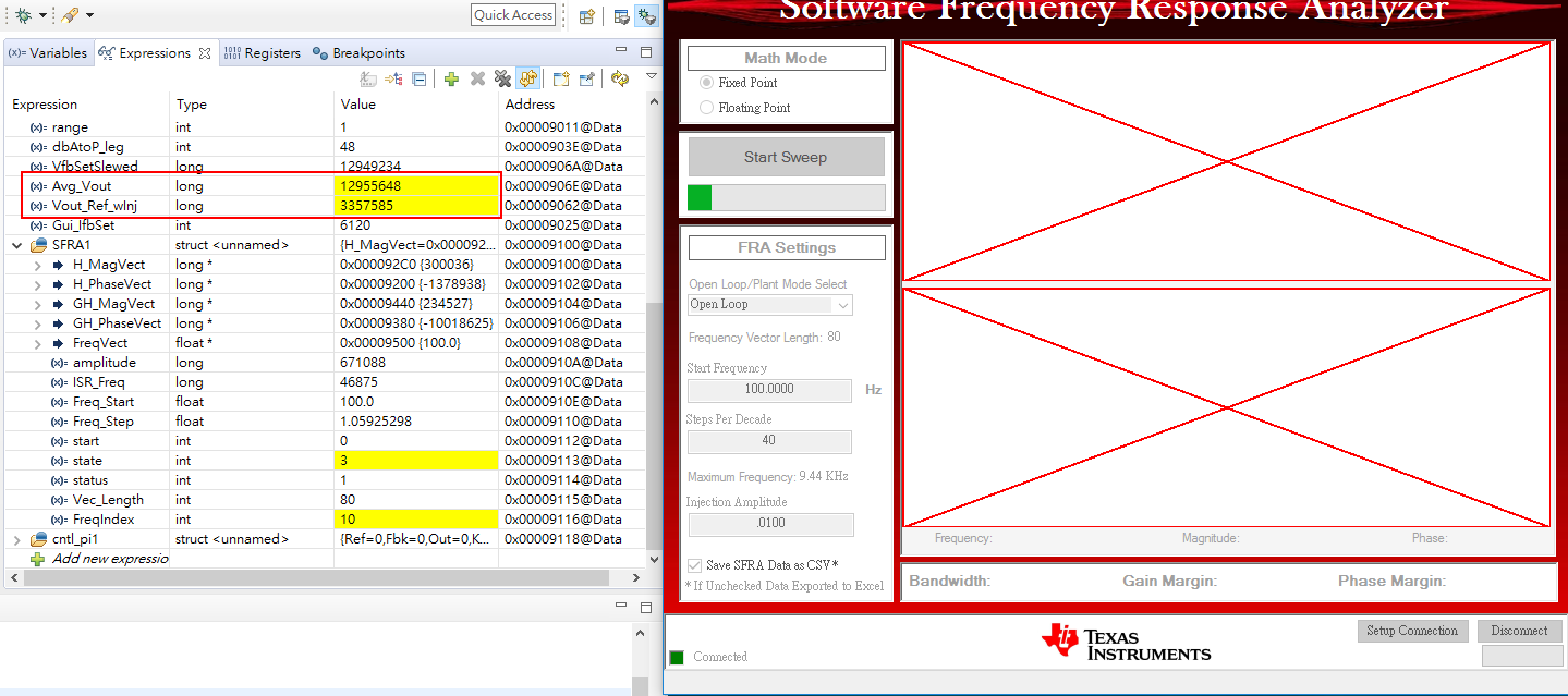

I have been porting the SFRA Library into my project recently, but there seems to be some problems with the results I got from the GUI when I did the open loop frequency sweep. Would you please be kindly enough to help me fix it.
My project is a DC/DC converter using the phase-shifted full bridge circuit, and the MCU is F28035 with 47kHz PWM frequency, and the program was modified from TI's example(HVPSFB).
I’m trying to use the SFRA tools to get the open loop with peak current mode control of converter.
The GUI can connected and start sweep. The problem is that when sweep is end, GUI  shows "Unhandled exception has occurred in your application".And the information in the CVS file is incomplete,
I have below code in my 47K ISR.
interrupt void DPL_ISR_wFRA(void)
    if(EPwm1Regs.TBSTS.bit.CTRDIR == 0)
        Vout_Ref_wInj = SFRA_IQ_INJECT(Iref);
        DPL_Func();
        SFRA_IQ_COLLECT(&Vout_Ref_wInj,&Avg_Vout);
    else
        DPL_Func();
    EPwm1Regs.ETCLR.bit.INT=1;
    PieCtrlRegs.PIEACK.bit.ACK3=0x1;
and DACDRV macro : DACDRV_RAMP_In1 = &Vout_Ref_wInj;
I’m wondering is there something wrong with my implement. Please help me. Thanks.

  • Hi Hrishi & Manish,
    In the example code of PSFB, the ISR runs twice in every switching cycle but the control code only executes once.
    The control flow(HVPSFB_User's Guide_v1.1) like this:
    In the previous test, SFRA inject is being called in the "Counting Down mode".(EPwm1Regs.TBSTS.bit.CTRDIR == 0).
    I had try to call SFRA inject in the Counting Up mode when open loop, but it seems no effect.
    Do you have any Idea? If you need, I could provide you some more information.
    When you have SFRA integrated in your project this way, does the converter still work properly in open loop? I ask this because there is quite a bit of time-critical code that is executed inside the ISR. I want to make sure that after integrating SFRA into this code the basic PCMC algorithm has not broken. If it has (broken), then the timing for ISR triggering will need to be adjusted along with some of the other parameters inside the ISR.
    The other thing I want to be sure of is that the Vout feedback is being correctly read by the ADC. If you already have a project with closed voltage loop working without SFRA, then you can ignore this comment.
    Hrishi
  • Hi Hrishi,
    After integrating SFRA into this code, I adjusted the time to enter the ISR.(only the value of trig_up&down variables)
    When SFRA start sweeping, the value of Vout_Ref_wInj is changing and Vout is ring but still have output.
    After a while, the value of Vout_Ref_wInj is static,  and Vout is stable but still have output.
    So I think the converter still working when SFRA sweeping, and PCMC algorithm has not broken.
    What does it mean when the state of SFRA structure is equal to 2 or 3?
  • Add the waveform of Vout and Vout_adc.
    SFRA starts sweeping:
    After a while, the value of Vout_Ref_wInj is static,  and Vout:
    For your reference, thanks.

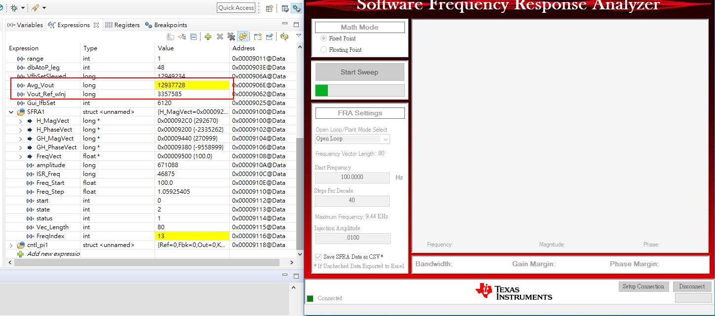

  • Ku,
    Looks like SFRA is working correctly, as I see sinusoidal injection. Between frequency points there is a dwell time and hence the no disturbance period.
    Can you see the variables in the IQ24 format.
    Also can you also see PlantMagVect and Phase Vect in the watch window in IQ16 format ?
    I do know your GUI is crashing, but the GUI can crash if the frequency response data is not well formed. This is a known bug in the GUI. UNfortunately with no immediate fix.
    However the main issue at hand is of the response being plotted is correct or not. Hence can you watch it in IQ16 format and post your watch window expressions here.
  • Hi Manish,
    This is the beginning of sweep, and the variables is in the IQ24 format
    After a while, Vout_Ref_wInj will equal Iref and not change again(static). ,  Vout is stable but still have output.

    I don't know why is broken when index of SFRA ran to around 10.
    By the way, it's test by open loop, and SFRA_FREQ_LENGTH is change to 80.
  • Based on what you have shown above the FreVect is set to 0 beyond index 12, why is that?
    Is it the same at start ? looks like something else is writing to it?
    You did not have it zero when you ran the STB check?
  • I think you are right, it might be written by something else.
    When power on(Vout ok) and SFRA is not start, the data of FreVect  is correct, after SFRA start sweep, the data of FreVect change like above.
    Then I found the data of FreVect was changed when the program running to SFRA_IQ_INIT(&SFRA1) in the judgment of initializationFlag, but I don't know why.
    Now I use the way "Using SFRA without SFRA GUI integration" to run SFRA, and get the data at open loop status.
    I change the data to IQ16 format and save as a CVS file. Open by the GUI, and it seems very unstable.
