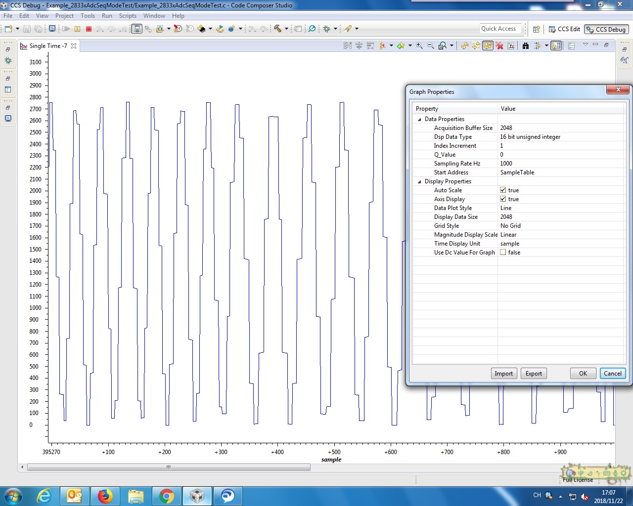

Dear Team:
Recently I am doing the ADC test experiment with the F28335 Experimenter Kit. And I use the example routine at below location:
C:\ti\controlSUITE\device_support\f2833x\v142\DSP2833x_examples_ccsv5\adc_seqmode_test
When I gave a 1KHz and 0~2V Sine wave to the ADCINA0 channel, I got a wrong wave in the graph as show below:
Did I make the wrong setting of graph?
Or any other problem?
Best Regards
  • Setting
    Is your sampling rate 1kHz correct? Can you paste the code?
    Gautam

  • F.F,
    That appears to work on my setup.  Can you try with a DC signal first to make sure it works as expected?  Then start with a slow frequency (like 2Hz) and see if there's an input frequency where the graph stops working.

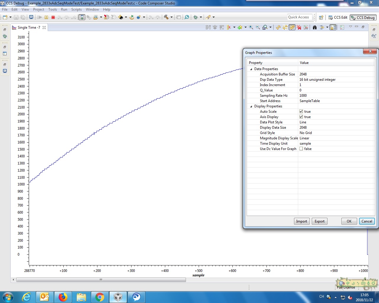

  • Dear Tommy:
    Below is the wave of 2Hz, 100Hz and 1.1KHz. And the 1KHz sine wave is the same as the previous one. I have no idea about those phenomena. Can you give me some reminders?
    1, 2Hz
    2, 100Hz
    3, 1.1KHz

  • F.F,
    It looks as though your device may not be running at the expected frequency.  You can check the ADC sampling rate in the example by toggling a pin like GPIO31, which also happens to control the LD2 LED on the controlCARD.
    Please modify the example with the following:
    Configure GPIO31 to be an output by adding this between the "Clear SampleTable" loop and "Start SEQ1" instruction:
        EALLOW;
        GpioCtrlRegs.GPAMUX2.bit.GPIO31 = 0;  // GPIO31 = GPIO31
        GpioCtrlRegs.GPADIR.bit.GPIO31 = 1;   // GPIO31 = output
        EDIS;
    Then toggle GPIO31 in your ADC sampling loop by adding this after the INT_SEQ1_CLR bit is set:
        GpioDataRegs.GPATOGGLE.bit.GPIO31 = 1;
    You can expect to see a square wave of about 368kHz using an oscilloscope on GPIO31 of the docking station.  The LED should appear to be on.
    -Tommy
