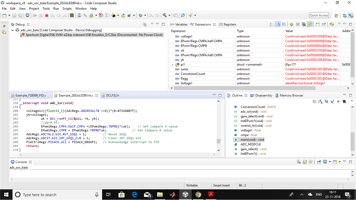

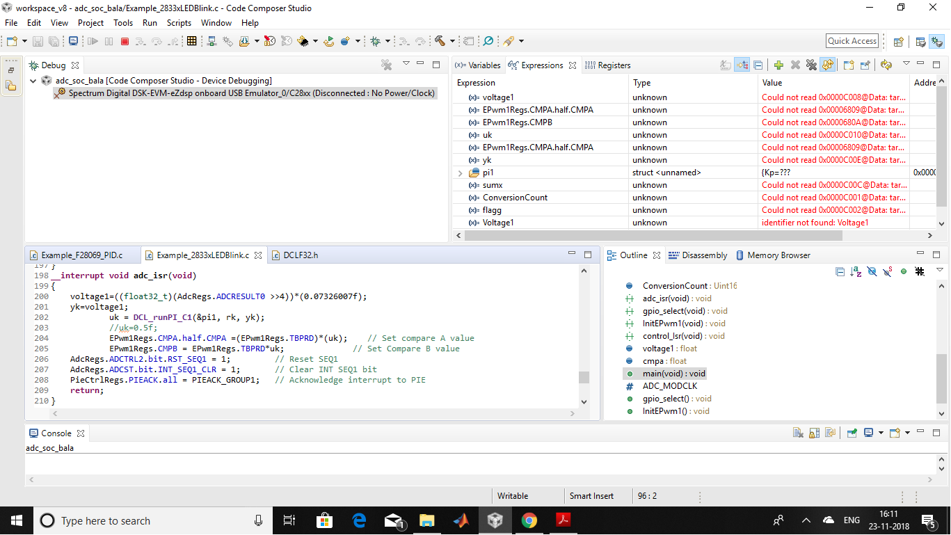

  • Thank you for your support sir. I have done the corrections you said but when I am turning on the supply with dc input of 10 volts code composer is showing like this below. I have doubt like whether I have to use 'DCL_runPI' command or 'DCL_runPI_C1'  but in SPRUI31 saying like use 'DCL_runPI' . I didn't find the library in my system in the 'DCL folder'.
  • You are very welcome.
    If switching on the power causes the emulator connection to be cut you have a hardware issue. Check your power and ground layout, and monitor the power rails as you apply the power to be sure they are clean and do not move outside the absolute min/max ratings for the device. If you suspect the controller is at fault, try reducing the PI gains, but it is likely a hardware issue you are facing.
    Literature reference SPRUI31 is the User's Guide for version 1.0 of the library. The current DCL version is v3.1 and is available with C2000Ware. Some function names in v1.0 have been deprecated, including the PI controller. Please check which version you are using and refer to the user's guide for that version. If you can, I recommend you download the latest C2000Ware and work with that.
