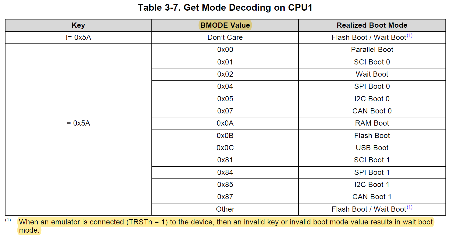

My application toggles GPIO on F28379D launch pad. The boot switch of launch pad is set to “1”, “1”, “1”. I find I am not able to boot the program from flash on power up using my own CMD file (please see attached).
The program counter is trapped at address 0x3FF16A, which located in Boot memory. Is it related to “Wait Boot Mode”? If I change the CMD file to “2837xD_FLASH_lnk_cpu1.cmd” everything works well.
For “2837xD_FLASH_lnk_cpu1.cmd”, BEGIN is at the front of FLASHA at address 0x080000. But, in SECTIONS part of CMD file, it didn’t even use FLASHA, if there any reason for this? I would like to know what’s wrong with my own CMD file.
BTW, any document describes CMD file in detail?

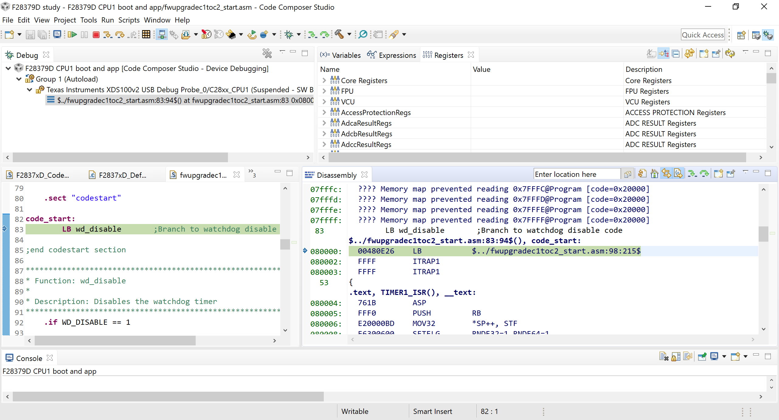

Sheldon
  • I uploaded the wrong one, this CMD is actually getting some problem.

  • in the original file codestart was going to FLASHA. In your modified file you are directing codestart to BEGIN which is at address 0x80000.
    I suppose this is causing the problem. Can you update this and check.
    0x80000 is where the first instruction of your application resides. With your modified cmd file you seem to corrupt that.
    Baskaran
  • Baskaran,
    I have move the program to FLASHAtoG which start at 0x080002, after code start branch which reside at 0x080000.
    Sheldon
  • i believe you shouldn't touch 0x80000 to 0x80002. Your code start should go to 0x80002.

  • Hi Sudharsanan,
    Attached is my screen shoot.
    I have some new finding and the root cause seems behind the CMD file.
    Actually, if I load the PC with some value whose flash content not properly programmed e.g. LB to some blank flash area (without any instruction there). An illegal ISR will trigger. When I POR the device, the main function seems never enter again. If I comment out the LB, POR will be fine.
    Sheldon

  • Hi Vivek,
    I see below chart in TRM.
    I think either an invalid key or boot mode value cause the device enter wait boot mode when TRSTn = 1. So, I care about will "LB" to some invalid address influence the "key" or "boot mode value"? If so, how does it make it?
    Sheldon
