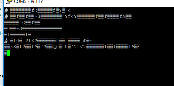

  • Please take a look of the read result. Do you know what this problem is? thanks

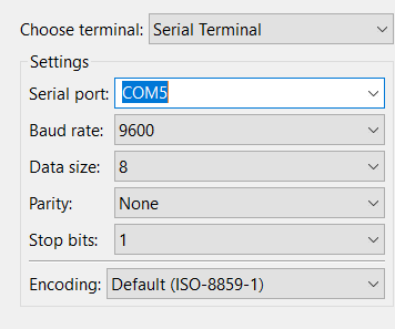

  • Hi Michael,
    The project settings look ok. If you are seeing some junk data on the putty, it could be possibly because of wrong baud rate or other settings. Can you confirm whether the following is configured the same as in your project?
    • Baud rate
    • Data Bits
    • Parity
    • Stop Bits
    Veena
  • COM configs are ok.

  • Hi Michael,
    The oscillators present in control card and launchpads are different. You may need to add a symbol _LAUNCHXL_F28377S in your project so that it picks the correct oscillator frequency and hence your baud rate calculation would be correct.
    To add a predefined symbol, go to Project properties ->Build->C2000 compiler->Predefined Symbols and add "_LAUNCHXL_F28377S" in the tab Pre-define NAME.
    Veena
