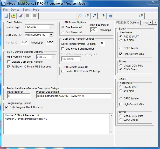

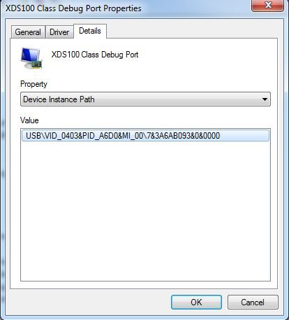

As mentioned in other forum questions i understood that this is due to driver problem. When I check my driver details it is not as recommended and as follows,
I tried to resolve the problem as specified in
but when i'm doing that MPROG cannot identify the device and screen shot is as follows,
Please guide me to overcome this promlem
