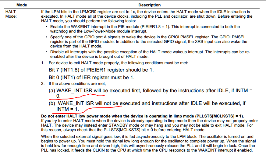

I would like to the device to enter into and exit from low power mode, and the configuration and handler code shows below, can you please help to review the code? Is there any risk especially the disable and reenable interrupt ?

  • Another question:
    Can you please help me to understand the below red marked items?
    If INTM = 0, the device will be exited from halt mode once IDEL instruction executed even no GPIO wake up signal generated, isn't it?
  • Jack,
    That being said here are my thoughts:
    1. If INTM = 1, the MCU will enter HALT mode as normal. once the valid GPIO external wakeup is received, the application will continue executing from the next line after the idle instruction. it will not jump to the WAKE_INT ISR.
    2.It seems like you are being needlessly complex with entering halt mode. You do not need to save then restore the entire PIEIER table. otherwise the code appears to be fine. you have the critical pieces of HALT mode entry and exit. The bare minimum is documented in the C2000Ware example (lpm_haltwake)

  • Hi Mark,
    Thanks for your suggestion. I will pasted my code as your suggested in future.
    Regarding to your comment, "You do not need to save then restore the entire PIEIER table. ", but the reference manual says, Disable all interrupts with the possible exception of the HALT mode wakeup interrupt. The interrupts can be reenabled after the device is brought out of HALT mode, how to understand this?
    Actually, I didn't save and restore PIEIER table before with using the example code in controlsuite, but sometimes I find the device didn't wake up normally. And I'm sure that the GPIO wake up signal is pretty good, with 11ms low pulse, and the signal generated in every 2 seconds.
    If no need to save then restore entire PIEIER, it seems that my code still have some risk that device won't be able to wake up, can you please share your comment of how to configure device to be able to wake up normally?
  • Ah, I appear to have been mistaken with my PIEIER comment, I mistakenly thought you were remapping the whole vector address table. This is actually a reasonably efficient way to disable all interrupts.
    The code looks fine, it was my misreading of it that was the problem.
    The only thing I would be careful with from an application standpoint is to ensure that your system is prepared to enter an LPM. I.e. ensure that the SPI isn't actively transmitting a message as the System clocks are disabled or something similar like actively toggling PWMs on a power stage. You must prepare the system to be halted. It could be a challenge recover the system if certain modules lose synchronization or even catastrophic!
