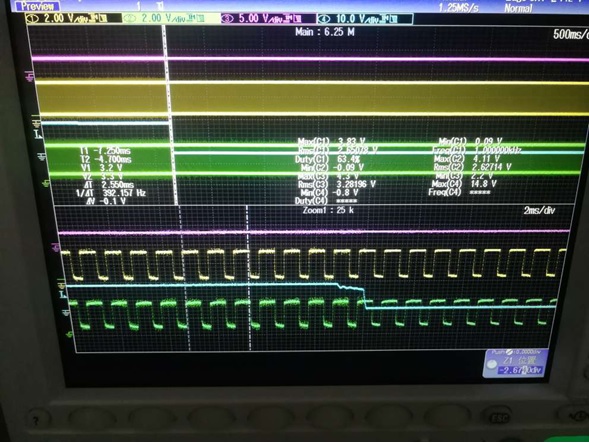

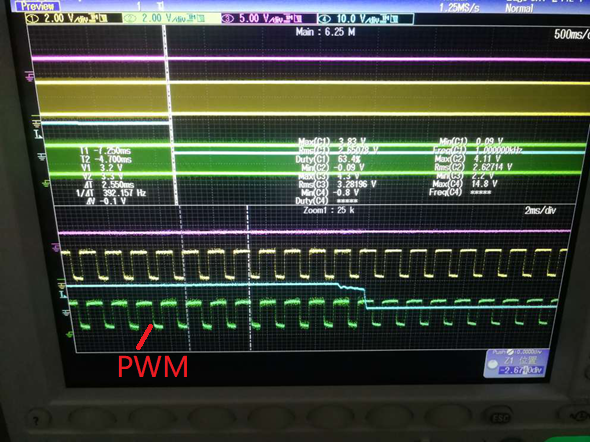

My customer use eCAP to capture PWM wave. To count when switch between high and low level to know the time on high and low voltage. It is used to
calculate PWM frequency and duty cycle.
Read value periodically. We find the value is "0" sometimes during low voltage. But no this issue during high voltage.
The count should be some number, but why it's zero during low voltage?
Nothing unusual on waveform.
Count is zero during low voltage.

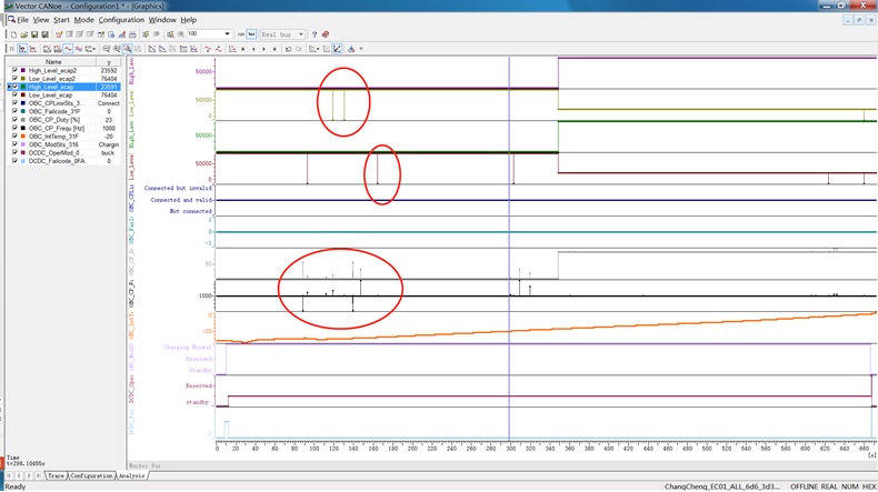

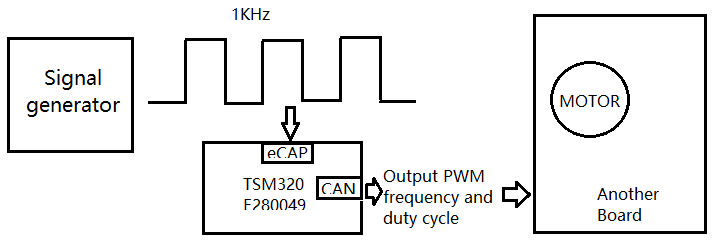

The green wave is the PWM waveform that fed to eCAP.

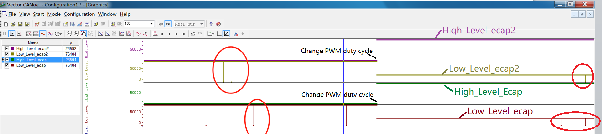

Use two eCap to capture the same one PWM. As you see on below picture, there are no "zero" count value at High_Level_ecap2 and High_Level_ecap register.
But it has "zero" value happened on Low_Level_ecap and Low_Level_ecap2. Even we changed PWM duty cycle to recount.
There is a important finding that it have above issue if load the motor. If unloaded motor, just use eCAP to count PWM waveform, it hasn't this issue.
