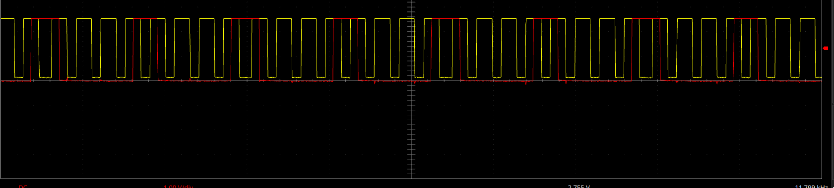

  • Problem with lock on SPI_readDataBlockingNonFIFO() solved. first reading clears INT_FLAG register, and then this register dont set anymore. To read from SPI you should writ dummy data to SPIDAT register.
    But, anyway its not works, looking like clocking scheme is not Rising edge with delay (no enough delay in my case), but CLK_PHASE set to 1.
    software (working) write 0x11
    hardware (not working) write 0x11
  • That's correct. To read valid SPI data from the slave, the master needs to initiate a transmission. The master needs to clock the data OUT of the slave, this is accomplished through a dummy write.
    The difference between the working and not working captures would appear to be purely a timing issue. The C2000 SPI will change the SIMO pin immediately on the edge. Your working capture shows that there is nearly 1/4 cycle delays between each transition.
    What does your slave expect? the Master is transmitting data on the rising edge and sampling it on a the falling edge. Your slave should match that.
    -Mark
  • ADS1259 works in SPI mode 1, polarity 0 phase 1. As documentation says: Data and control communication are handled over a 4MHz. So i set my SPI to lowest bitrate.
    strange situation, in mode 1 i recive nothin, but in mode 0 i recive some data. from my really bad logic analizer a see that MOSI pattern is unstable. what can i check more?
  • Pavel,
    Compare the ADS1259 Polarity and Phase definitions. All SPI's seem to choose different definitions. Make sure the F28379D and the ADS1259 are transmitting on the same edge and receiving on the same edge.
    It looks like the ADS1259 will transmit on the rising edge and receive on the falling edge of the clock. See Figure 1 in the ADS1259 DS. To match that on the F28379D, choose POL = 0, PH = 0. You can look at the timing diagrams in the DS to determine this, or the SPI Clocking Scheme Selection Guide table in the TRM http://www.ti.com/lit/spruhm8
    -Mark
  • Thank you for your answer, it doesn't solve my problem directly, but it helps me to take a sober look.I have tried POL = 0, PH = 0 but it give strange result. I looking all documentation again and understood that you are right, POL = 0, PH = 0 it's what i need. and next i started to looking for another sources of mistakes. i found that i receive first byte CONFIG1 with correct values, but not in first position and another registers returned zeros. So, i changed CONFIG1, set SPI bit to zero (setting SPI really resets ADS1259). After this i received almost all registers, they are looks one byte shifted. solution of this problem was much more obviously. reading SPIRXBUF register after sending write register command to clear INT_FLAG before receiving data.
    Now it works on full range of speed.
    thank you a lot.
