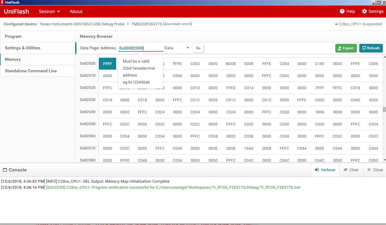

I tried using UniFlash to see if I could connect to the device and access memory. This worked fine and I was even able to read the sectors of memory in question from the failed CCS debug. Below is a screen capture of several memory reads into flash as well as a successful verify image attempt.
Flash Sector B
Flash Sector G
Verify Image

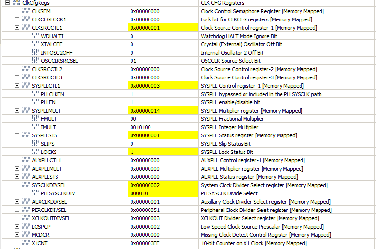

Trying to force the device to wake up fails, so I restarted and assembly stepped into the function until the failure occurs. The failure occurs trying to to the PLLSYSCLKDIV register and throws a can't single step error.
I captured the CPU status registers (ST0 & ST1) as well as the PLL registers before the error, but nothing seemed out of the ordinary.
I think the device might be damaged, but im not sure. Any assistance in identifying the issue or determining the health of the device is greatly appreciated.
