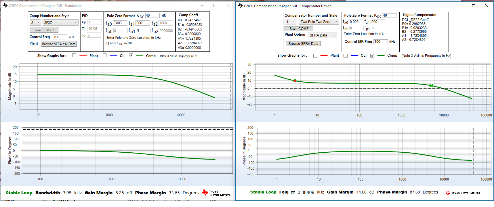

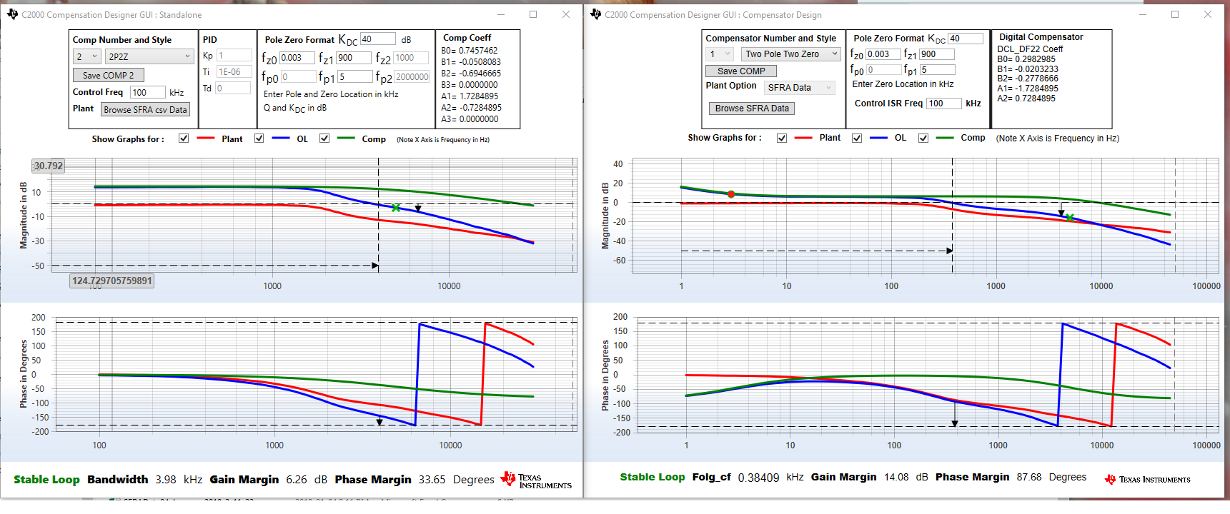

  • The crossover of the open loop certainly.
    But what I'm seeing is that the plant data is being changed as well (red line).  That should be static.
    Below is a screenshot of the "SFRAData.csv" that gets installed with version 1.02.
    On the left: is the data in the old compensation designer with the knee in the plant about 1.2kHz... Crossover at 4kHz
    On the right: is the new compensation designer  with the same data and same poles and zeros..  notice the red line has moved and the knee is now at 200Hz...  and this obviously affects the Open Loop crossover as well.  This is incorrect.  The plant should be fixed.
    The data clearly shows that the knee is about 1.2kHz .  The plant doesn't move with control frequency (you might lose phase, or gain near the control frequency, but not like this).
    This doesn't match your documentation which shows this data correctly (plant knee at ~1.2kHz.  So at some point it worked well...  It does not on my machine after a fresh install.
    I also added the same controller a 2P2Z with the same poles, zeros, and magnitude and get totally different graphs and the B coefficients are different (accounting for the sign change you mentioned in the A coefficients).
    The second image is just the compensator using the same values...  that doesn't even match...
    If it helps the File Version from windows details says 2.1.0.0, and Product version is 2.01.0.0  (old version is 1.10.0.0 and 1.10.0.0 respectively).

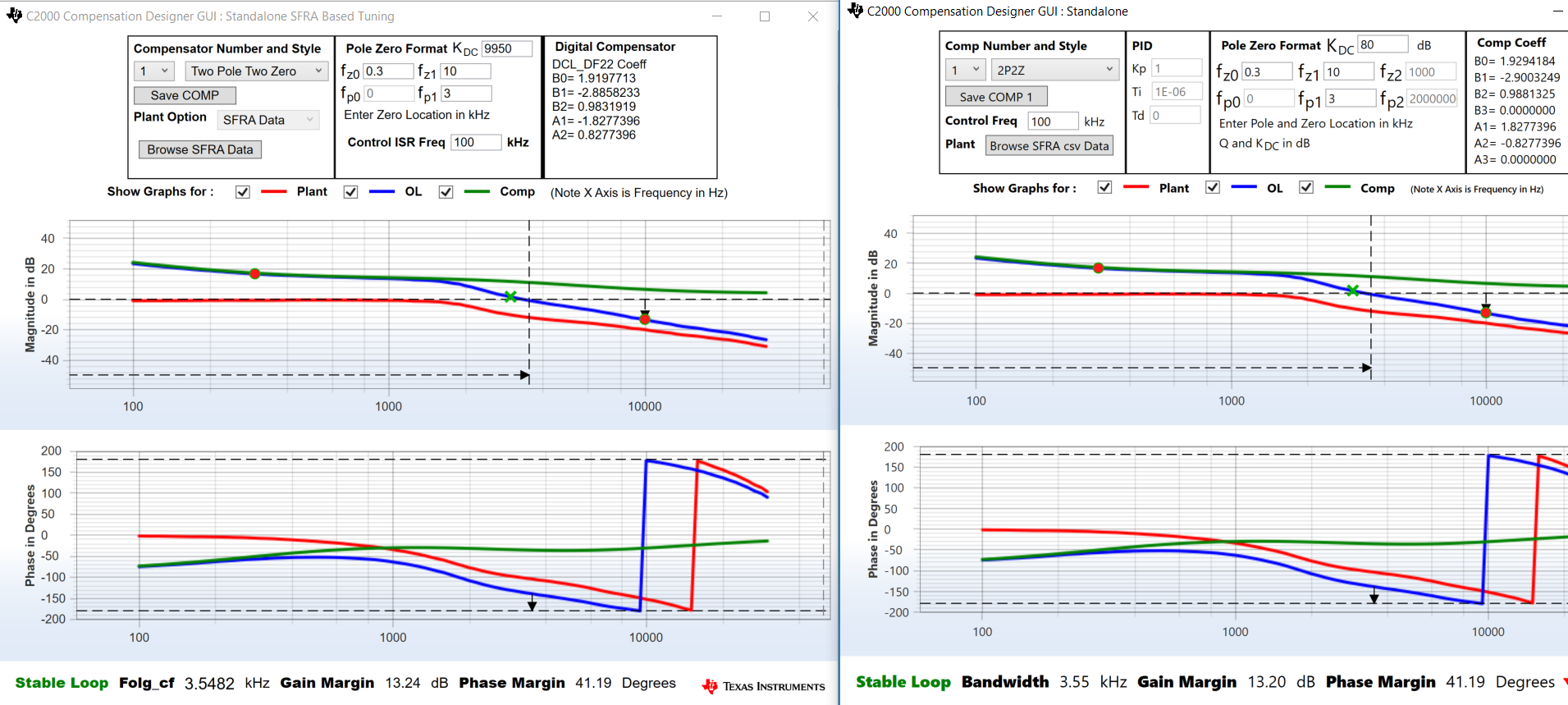

  • Kyle,
    I checked back at this and am unable to repeat the issue.
    Can you confirm both the GUI's are pointing to the same SFRA data.csv
    For example I pointed them both to the SFRA data.csv and with all the settings correct I am able to get the same results.
  • I believe the issue you might be seeing is that in the new compensation designer Kdc is no londer in dB ??
  • Confirmed, same file (and files... I tried this with multiple files).  I wouldn't go through the trouble of saying there is an issue if I did do this.
    I can see your plant is identical between the two.  That is not the case with mine... this is where there is something off.  Please post a zip file with your compensation designer and the associated DLL to make it run.  I'm attaching a zip of my non-working one with the example plant that data shows 1.2kHz knee, but shows up as 202Hz in the comp designer.
    In no case should the plant ever change.  Those are measure values and will not shift.  The fact that mine are moving is incorrect.
    NonWorkingCompDesigner.zip
  • This would be the case as to why the compensation is different... I get that. But still, the plant should never move... that is the bigger issue.
  • Kyle,
    I was able to re-create the issue with the files you sent.
    It is coming because of transition from compensator designer mode to SFRA based tuning mode in the Compensation Designer.
    The compensator designer mode sets the freq steps to be 1- fsw/2, however when one switches to the SFRA based tuning it is not re-adjusting the freq steps arrays which is based on the SFRA measured data and causing an error.
    A workaround to this issue is, open Compensation Designer, browse to a valid SFRA data.csv file and open (I understand the data might look incorrect at this very instant).
    Next, click "save Comp", then close the compensation designer.
    re-open the compensation designer, as now a valid SFRA data path is available, it will open in SFRA tuning mode and it will not show the weirdness we discussed above.
    I will file a bug against it [SFRALIB-42]. This was a new feature we added in the v2. We did not notice this bug, as we had a valid path in Comp.xml that was on my machine and never transitions to SFRA tuning from compensation designer mode.
    Sorry for the inconvenience it may have caused.
    Happy new year to you!
    -Manish
  • Manish,
    Good, I'm not crazy.
    The save comp didn't fix the issue, but manually changing the path in the XML file to the SFRA directory did. Not sure why the save comp button didn't work, but either way it appears to work now.
