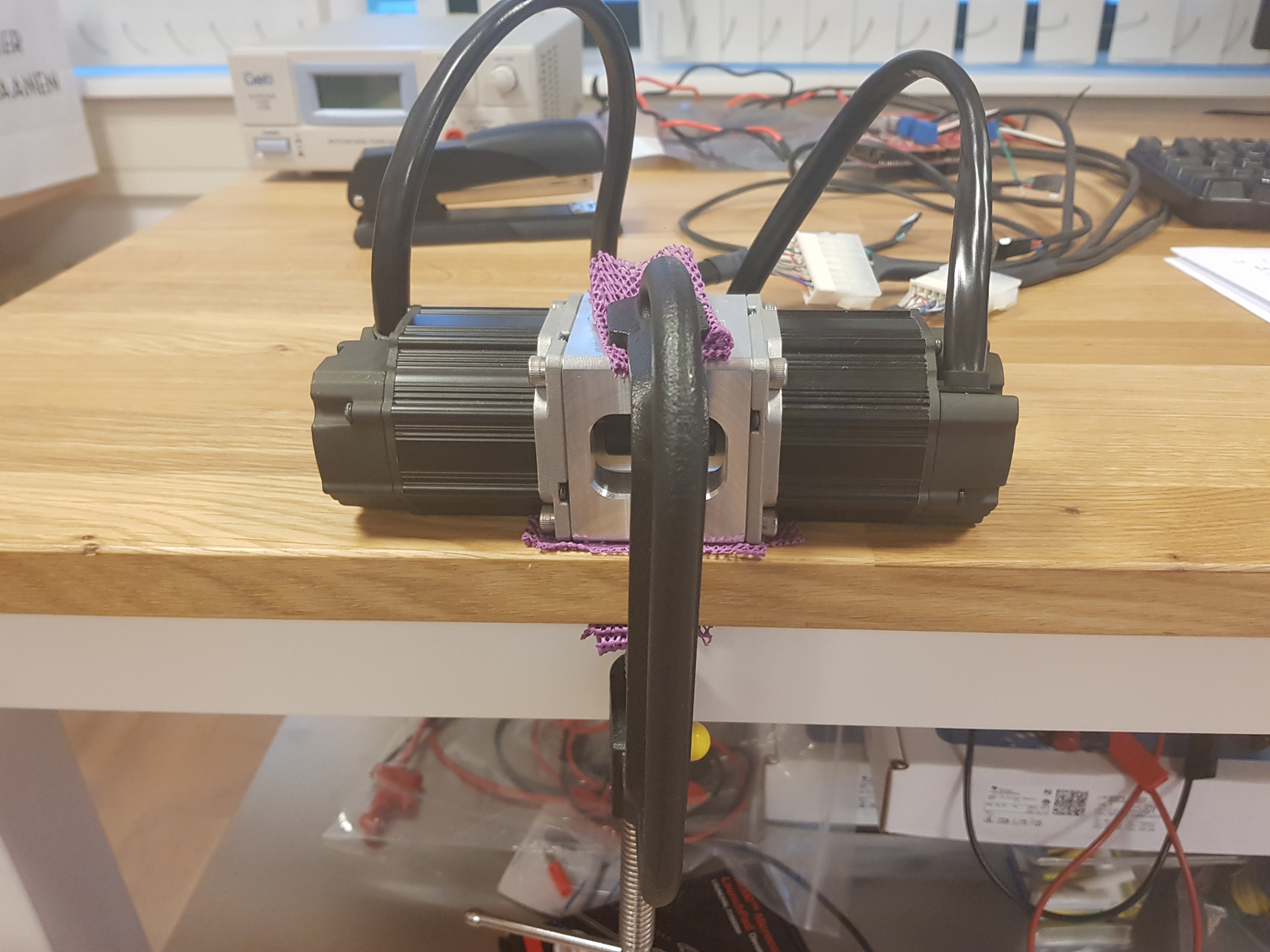

  • Good afternoon Sean,
    I just have one quick question regarding lab 10D,
    I have worked through all the labs you recommended but have some issues here.
    When I want to drive both motors ( as seen in the included picture) and follow every step the problem i found is the following.
    Both engines are connected on one shaft when I run one engine there is no issue.
    But when I want to run both engine ( second engine with 0.0 speed ref and acceleration ref) the system starts to stutter.
    I stopped the second engine immediately, does this problem occur because they are both on the same shaft ?
    If i want to run the second engine as a generator ( like mentioned in the first question ) do I have to use lab 6E, because of the problems found with this lab ?
    Thanks once again and have a great weekend
    Robert

    I hope to clarify my test setup a little bit
    These are the two DC motors connected to one shaft. Each motor is connected to a motor controller and  both motor controllers are connected to one launchpad.
    With lab 11d,as you adviced I want to use the left engine as engine and the right engine as generator.
