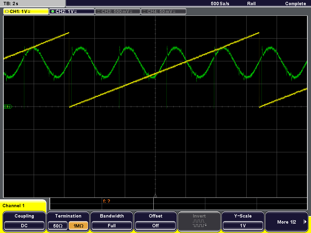

I have issue with STPOSCTL torque reference. There is a disturbance every one rotation from output STPOSCTL torque reference. This disturbance is not show when I use output (input for ctrl Iq ref) PI speed controller. When also set BW to higher value there is a loud "tick".
In the first figure green is torque refence and yellow is STPOSCONV output. BW is 20 and it is value what i need for stiffness.
the same with BW 5
output from PI speed controller
I try another motor and the same. With another motor this not happend, only with very, very high BW.
