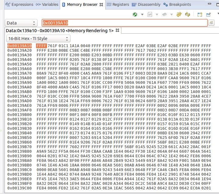

i am parsing HEX files and cannot get the alignment correct. When it attempts to write to a odd address it is still FFFF in the memory browser.
Data record: Bytes: 06 Address: 00139AE0 CRC: 82 Data: 76 1A FF 69 00 06
Data record: Bytes: 20 Address: 00139AE3 CRC: 61 Data: 00 73 00 77 00 7A 00 7E 00 82 00 86 00 8A 00 8E 00 92 00 96 00 9A 00 9E 00 A2 00 A6 00 AA 00 AE
Data record: Bytes: 20 Address: 00139AF3 CRC: 4A Data: 00 B3 00 B7 00 BB 00 BF 00 C3 00 C7 00 CB 00 CF 00 D3 00 D7 00 DA 00 DE 00 E2 00 E6 00 EA 00 ED
Data record: Bytes: 20 Address: 00139B03 CRC: 9B Data: 00 F1 00 F4 00 F8 00 FB 00 FF 01 02 01 06 01 09 01 0C 01 0F 01 12 01 15 01 18 01 1B 01 1E 01 21
Data record: Bytes: 20 Address: 00139B13 CRC: BC Data: 01 24 01 27 01 29 01 2C 01 2E 01 31 01 33 01 36 01 38 01 3A 01 3D 01 3F 01 41 01 43 01 45 01 47
I have the following flags set in the hex utility:
--romwidth=16 --intel
i am using ALIGN(4) in my linker.
This code gets placed correctly when used with the debugger but the hex does not work. Are there any additional flags I can set when generating the hex to force the correct alignment?
I appreciate any help. Thanks!

  • I have been out for the holidays but thank you for the reply.
    I am using a custom hex parsing program but the issue is how CCS is creating it. I dont believe it should be starting the line with an odd address.
    When this is done the micro controller tries to write to and odd address and fails. Is this the correct thinking?
  • I found that there were additional libraries that had respective linker files. Once I hunted these down and aligned them everything was placed correctly. I appreciate your attention.
