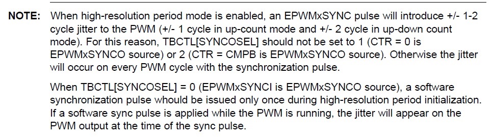

3. We did not fully understand the point of this note.
1) To avoid the jitter, the SYNCOSEL must be set to 0 when HR period mode is enabled, is it correct?
1) In our example code, a software sync is always performed during the initialization. Is it necessary to do this?
2) If TBCTL[SYNCOSEL] != 0 , is a software sync still necessary?

    For the question on jitter, a single sync pulse is fine. Do this is your systems requires it. If you then re-sync you may get a small jitter because the sync chain operates in the SYSCLK domain, not in HR domain. Thus if you configure your HRPWM to re-sync every cycle then you will see a small constant jitter each cycle.
    According to the TRM, TBCTL[SYNCOSEL] must be 0 if HR period is enabled to avoid the jitter.
    Then, how should we configure the ePWM to sync is we need a changing frequency control? Since changing frequency control requires
    sync every cycle, how to avoid the jitter?

  • Weiqi,
    Weiqi Wang said:
    According to my understanding, you are suggesting the configuration of CMPCTL[LOADAMODE] does not work when using HR enhancements since the internal registers only get loaded on CTR=0. Thus, we do not need to follow the following note, is that correct?
    My comments were specifically for Up-down count mode, and in that mode you should load on CTR=0.
    Weiqi Wang said:
    1) If both HR phase and period are used, do we have to set TBCTL[PHSEN] and HRPCTL[TBPHSHRLOADE] ?
    Yes.
    Weiqi Wang said:
    2) If only HR period is used, do we have to TBCTL[PHSEN] and HRPCTL[TBPHSHRLOADE] ?
    Yes, if you are using Up-down count mode. Yes, if you wish to maintain a phase relationship between multiple PWMs.
    If you need phase control between 2 separate HRPWMs there will be some jitter on a F28035 device. It will be 1 or 2 cycles. On newer devices  we have added the TRREM register to remove this jitter when syncing HRPWMs. You will need to determine if the jitter is acceptable for your system.
