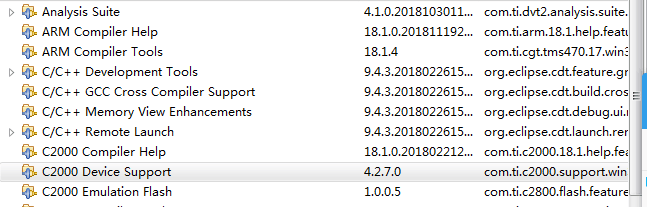

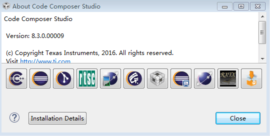

My customer is using F280048 and he found the latest CCS v8.3.0.00009 can not support this device.

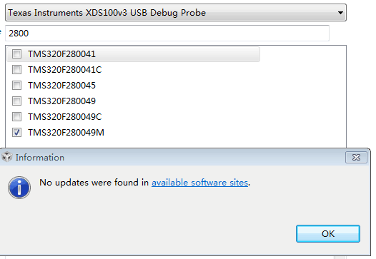

I asked him to try updating C2000 device support package but it indicated no updates.
He is now choosing F280049 for debugging but has some issues on reading ADC results in debug mode.
Please advise how should we fix this issue.

    I will look into the missing F280048 line item, in terms the selection of F280049 it should work for the F280048 device. The only difference is that GPIO12/13 are not on the F280048 to support Q grade temp in the 64 pin package. I would use the F280049 PN and not the F280049M device, however, as the "M" device is no longer being produced.
    Can you describe more on the ADC result issue in debug mode? Is the conversion incorrect/high error, or some other issue?

    I looked and I beleive they have been missing in 8.2.0 as well and I filed a bug report for that release. I have escalated the bug request since it was missed for 8.3.0. I beleive the next official release is sometime in Jan, this should get fixed worst case then.
    Matt
