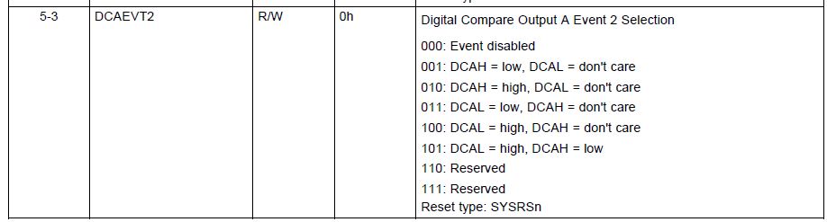

    I have routed output of COMP6H to the Trip 4 input using the ePWMXBAR. This Trip Input 4 is fed as an input to the DC compare unit.
    So as far as the DC unit would be able to see only the output of COMPH (single line) based on the configuration, am I right in understanding this? Or are you saying when the COMPH output is routed to EPWM XBAR, even the COMPL gets routed automatically to the DC unit?
    Now if this COMPH output is fed to DC compare, based on the TZDCSEL, what will the DCAEVT2 event generate for the different settings present in the TZDCSEL below. I am assuming that the COMPH is a single line of output fed to the DC compare unit using the PWMXBAR and TRIP input.

  • Okay so on EPWM XBAR, you enable mux 10, and set TRIP4 input to be CMPSS COMP H output.
    So far good.
    Then you make the input to the Digital Compare to be TRIP4, and you want it connected to DCA L.
    So now, on the DC module, you have CMPSS COMP H as input to DIGITAL COMPARE DCA L.
    Also correct.
    Then you set the DCA OUTPUT 2 to trigger when DCA L goes high.
    Then you enable the interrupt for DCA EVENT 2.
    We have NOT done anything with CMPSS COMP L.
    As mentioned above, the DCA EVENT 2 is generated when DCAL is HIGH, which means when CMPSS COMPH is high you will get a trip zone event and an interrupt.

    Let's consider another case, where DCA OUTPUT 2 is set to trigger when DCA H goes high. (code below). Now for this situation DCA EVENT 2 is generated when DCAH is HIGH, which means when CMPSS COMPH is high you will get a trip zone event and an interrupt. Am I correct?
    If the above statement is true then what is the difference between the DCA EVENT 2 generated for the 2 conditions mentioned below:
    1:
    2:
    Thank you
    Royston
  • You have routed your signal to DCAL , NOT DCAH. DCAH is connected to the defualt signal which I dont exactly know what it is.
    If you configure TRIPIN4 to go to DCAH, then you can use DCAH_HIGH to generate your event and I do not believe there would be a difference in those two setups as far as I know or at least for this application.

  • "If you configure TRIPIN4 to go to DCAH, then you can use DCAH_HIGH to generate your event and I do not believe there would be a difference in those two setups as far as I know or at least for this application"
    Perfect, this clears a lot of things. Thank you for taking your time to clarify the same.
