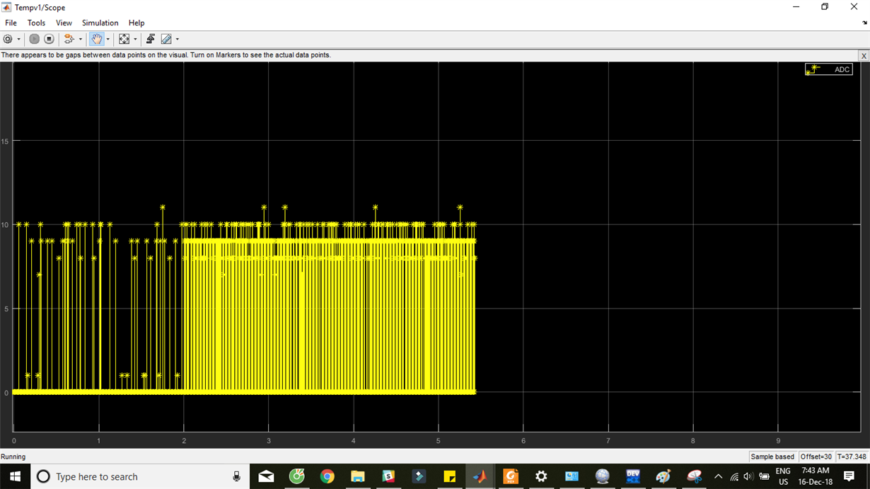

hi guys, i'm trying to measure the temperature via internal temperature sensor of the TMS320F28027. As i know, the ADCINA5 is internally connected to temperature sensor, so in SIMULINK, i take out the ADCINA5 and connect it to the scope block like this:

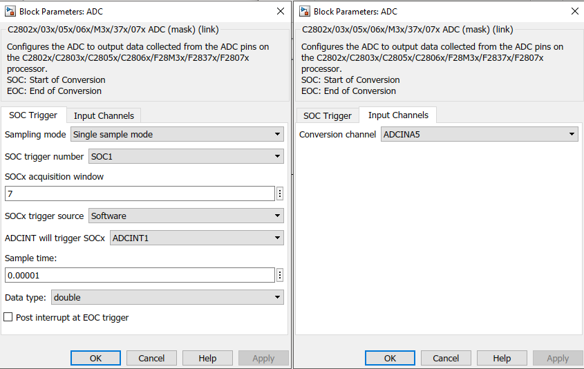

The figuration of ADC block:

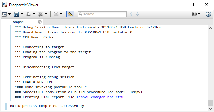

The code is built successfully:

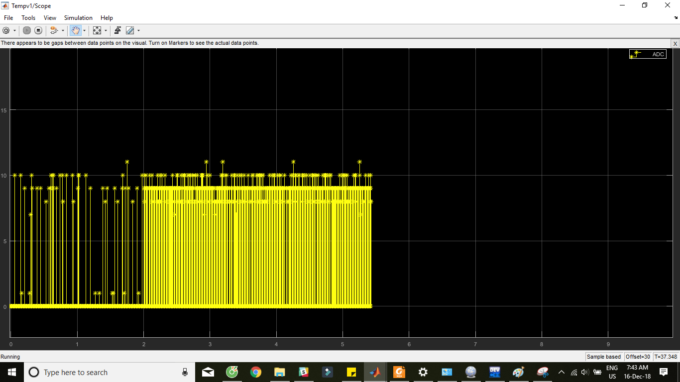

And this is the signal i 've got from the scope:
The maximum value it reaches is around 10, this is not true, i'm pretty sure the real temperature is much higher than that.
Where do i get wrong?, please help me.

    This forum is only able to provide competent support for device related questions.  As such, I can highlight that the TEMPCONV bit (as defined in the ADC Reference Guide) needs to be set in order to sample the internal temperature sensor:
    We do not have the expertise to tell you how this should be done in SIMULINK. You will need to contact them directly for SIMULINK-related support.
