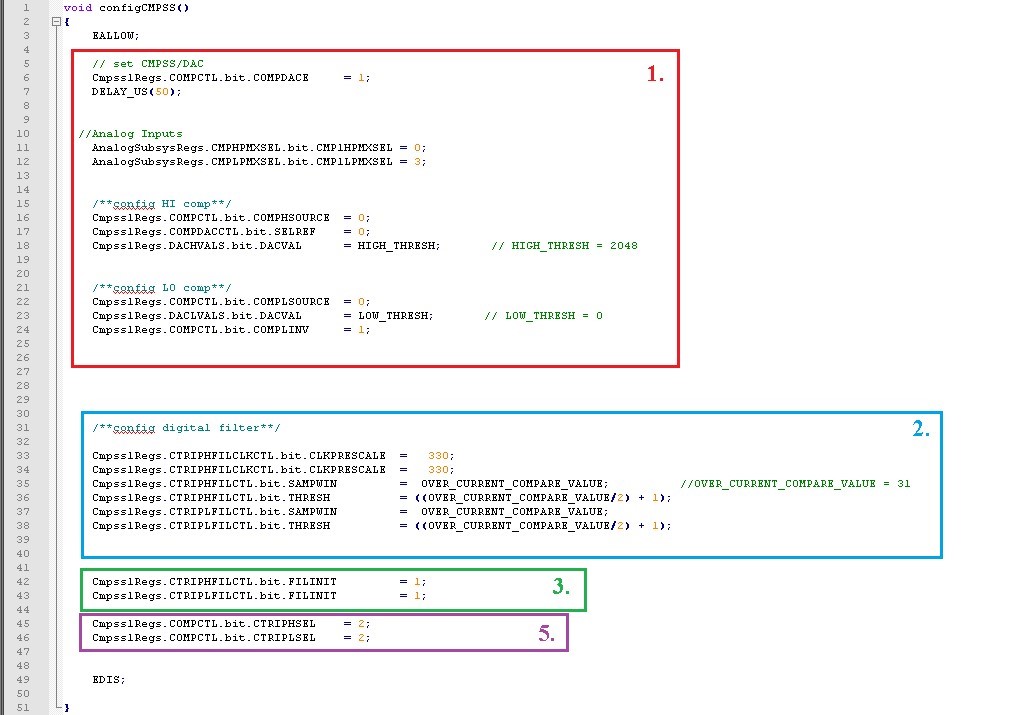

while debugging, I notice that the bit FILINIT (the one wich turn on the CMPSS filter) wasn't setting:
I followed the Filter Initialization Sequence (page 1496 - Technical Reference Manual) as you can see by the next two pictures:
(I've made these colors rectangles to make the visualization easier)
But is not working at all.
I'll be so glad if you all help me again.
- Severo

    FILINIT is not a latching bit. By that i mean after writing "1" to it, the bit will go back to "0". Writing "1" will initialize the filter after which FILINIT goes back to "0". Is your filter not initializing?
    Oh! I didn't know that, thank you! I thought it was a latching bit.
    Probably, the filter is initializing. My problem was with the bit going back to "0".
    Now, knowing how this initializing works, I will do another tests to verify the rest of the code. Thank you, again.
