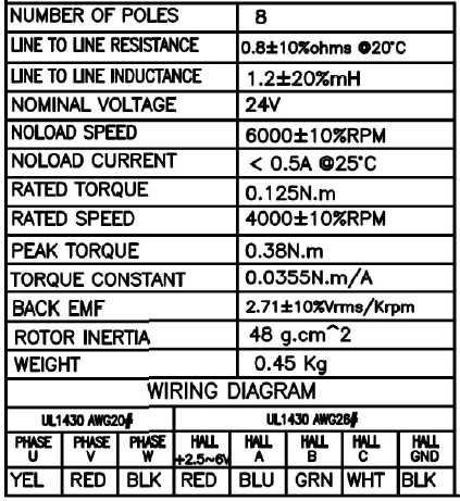

I am running lab5b from motorware with a TI motor (DT4260-24-055-04), the motor parameters are below;
The motor runs at the goal speed of 5000 RPM with no load, however the response is not as smooth as I would like. The steady state error of the motor speed is around 4.8% and I would like to get below 1%.

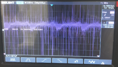

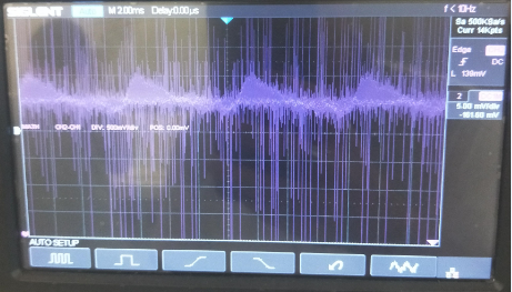

These are my output current waveforms which are incredibly noisy and not smooth so I think these might be the cause of the motor variance.
Phase A
Phase B
Phase C
How do I fix this issue? Are my parameter values in user.h causing the random current waveforms? Thankyou for any help in advance.

  • What type of probe are you using? A current probe? Or a voltage probe attached somewhere in the signal chain? This looks like it could be noise from PWM coupling into the probe if using a voltage probe
    Sean
  • Hi sorry for late response, yes I am using a Siglent PP510 voltage probe because I do not have a current probe to use. I have tried using the gAdcData function to display the phase currents inside Code Composers graphing function however the update rate was too slow in order to display the phase currents accurately. I have used a more accurate probe now to try and limit noise and these are the waveforms.
    These are the voltage waveforms and they can be seen to be distorted.
    The motor parameters didnt upload correctly too sorry here they are
    What could be the cause? Could it be an adc resolution problem?
  • These are also my gains
  • If you are asking what the cause of the noise on the waveform is, the cause is noise being coupled into the probe, most likely from the PWM module. You will need to use a differential current probe to achieve clean scope captures, there really isn't a way around this. As for your steady state error in speed calculation, can you describe better how you are quantifying this? Are you using a tachometer and comparing against the estimator speed feedback? Is it variance in the speed feedback itself? I'm trying to understand what we are trying to fix here
    Sean
  • Very sorry for the very late reply! Thankyou for you help so far Sean. When I run lab 5b, I would export the data values from gMotorVars.SpeedRef_krpm when the motor was running at 5000 rpm and calculate the standard deviation on 30 values using excel. I assumed the value of error I got was wrong and looked at the current waveforms and saw they were distorted and not the sine waves I was expecting. I guess I am asking why are the current waveforms like that? Is there something causing the phase current waveforms to be so distorted and non sinusoidal?
    Kind regards
  • You are using a voltage probe for the current probe screenshots, correct? I believe this is the issue, you will need to use a current probe for these waveforms
    Sean
  • Hey Sean thankyou again for the help, I have looked online and I wish i could get one but a current probe is too expensive for my project budget. I was wondering if it was possible to measure the current waveforms using a current sense resistor connected to the ADC responsible for the phase current. I have a dual input oscilloscope and am thinking I can measure the voltage drop across this resistor and use that to find the current waveform. Is this possible? Sorry if it is a silly question.
  • The trouble with adding a resistor in phase is that it will change the motor parameters as viewed by InstaSPIN. To avoid any issues, you should make the inline resistance a small value compared against the stator resistance. The problem here is, if you use too small a resistance, the noise coupled onto the line will most likely dominate your voltage measurement. Sorry to say that this is a difficult task to perform with just a voltage probe
    Sean
  • Oh okay I will avoid changing the parameters. Thankyou again Sean for the constant help!
