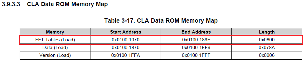

I've been looking through the TMS320F2837xD Technical Reference Manual (SPRUHM8G) and found that the CLA ROM contains something called FFT Tables:
What are they for?
I can't find any FFT routines for the CLA.
Are they designed to be loaded and somehow used by the main CPU?
The source code for this table ( c:\ti\c2000\C2000Ware_1_00_06_00\libraries\boot_rom\f2837xd\revB\rom_sources\F2837x_bootROM\cpu01-bootROM\Cla_Data_Rom\source\fft_twiddle_bit_reverse.asm ) contains the following comments in it:
;;//! For N = 1024-pt Complex FFT there are 10 stages
;;//! requiring 256 complex twiddle factors for the CLA implementation
This mentions a "CLA implementation". So is there an FFT available on the CLA?

  • Hi Alex,
    You raise a good point. The TRM doesn't describe this in more detail. The CLAMath library in C2000Ware also doesn't contain an FFT implementation.
    I did find the following, which is a hands on workshop demonstrating how to migrate over an FIR and FFT from the C28x to the CLA. Project files are also available for download. I looked through the solution files, and there are calls to a CLA_CFFT_run512Pt() inside freq_proc.cla, which is declared in cla_fft.h. However, the definition is not something I could find. I'm wondering if it is calling into one of the library files the project is linked to.
    FYI, I launched the project F28379D_CLAHandsOn_Solution and chose the CLA_CODE build configuration. There is a link to a library file c28x_cla_dsp_library_datarom.lib that I have not seen before.
    Also, I am not sure whether this project utilizes the CLA FFT ROM tables. These would be things I invite you to investigate.
    training.ti.com/cla-hands-workshop-part-3-workshop
    This training was put together by my predecessor, who is on vacation for a month. I'll shoot him an email asking for details, and will share any details I find (as soon as I hear back).
    Interestingly, this same person made a comment on FFT on CLA implementation (see below), indicating it as not feasible, but this was many years ago.
    e2e.ti.com/.../198374
    Please share what you find as well.
    Sira
  • Hi Alex,
    Any updates?
    What I've found is that FFT on CLA is doable (hence the workshop above), but it has limitations - limited RAM, only 2 registers available for addressing etc. Therefore this wasn't officially released. Probably the tables in ROM were left in case a user absolutely wanted to use the CLA for FFT, and use the main CPU for other operations.
