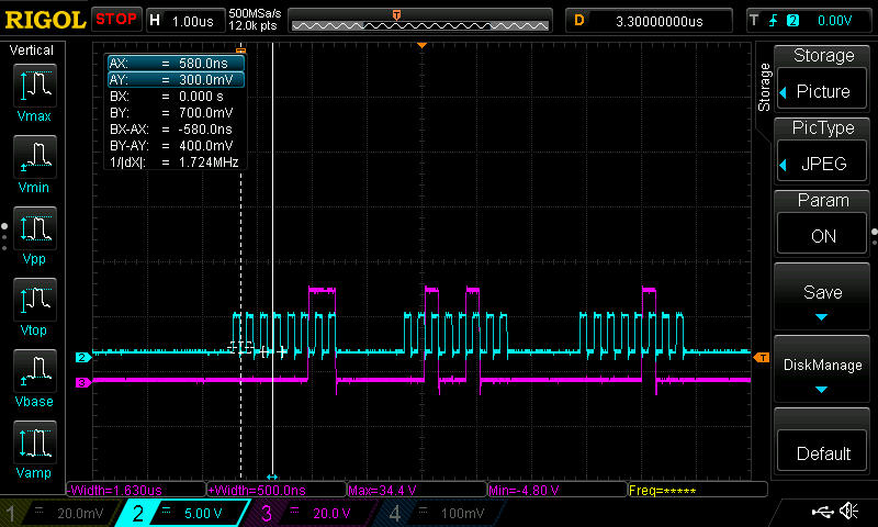

1. 28035 is able to send data to first ISL device over SPI (03 24 04) CRC is also calculated. The command is "identify".
2. The command transmission to ISL94212 is confirmed by waveform seen in CRO. The waveform is shown below
3. There is no response (not even acknowledge).
4. As written above, data sent over SPI is 03 24 04 and As per datasheet it should be 4 bytes and first three bytes should 03 30 0C indicating acknowledge by the first slave on SPI Line.
If we remove 28035 and connect the rest of daisy chain using to PC using Renesas USB to SPI converter (converts USB to SPI and vice versa) and use Renesas GUI, the GUI is able to communicate successfully.
However, we cannot see the parameters used by Renesas GUI to communicate with ISL94212 over SPI (clock polarity and phase, baud rate, etc). Further, since 28035 is not able to communicate successfully, we suspecting the communication between 28035 and ISL94212 is the problem.
We need to find out what is going on, why is ISL94212 nor responding in the way it should be
Can anyone please explain what is going on and what could be the problem?

  • Hello All (Especially Sal),
    Thanks for clarifying one point. We have been able to pursue with Renesas and have got partially around this issue. By Partially I mean following
    command from 28035: 0x03 0x24 0x04
    Expected Response from IS94212: 0x03 0x30 0x00 0x0C
    Actual response is 0x00 0x11 0x18 0x00
    What makes this weird is that CRO shows that ISL94212 is sending the correct response (i.e. CRO Shows 0x03 0x30 0x00 0x0C). It is just that read from TI RXBUF Reg is wrong. Can you please clarify why there is a difference between what is seen on CRO and what is read from the register? Am I missing something?

    Looking at your SPI configuration, Polarity =0, Phase = 1. this is "Rising Edge with delay" refer to SPI Clocking Schemes section in the new F2803x TRM. So essentially, the SPI will Transmit data on the falling edge, and latch in the receive data on the rising edge (the SPICLK Signal Options Figure is useful for visualizing this)
    • Can you show a capture of SPICLK, SPISIMO, and SPISOMI during a failing transmission?
    • Can you show a capture of the same, but when using the GUI instead of the F2803x as master?
    Please annotate these images, - which signal is which, what the data is expected to be, etc.
    Can you also explain the order of operations for the comms protocol? Your procedures in the last reply don't appear to be incorrect, but without knowing the protocol it is hard to be sure.
    • Does the master F2803x transmit the full command, then read back a full command?
    • Does the Master transmit 1 word command, then read back the response of that command?
    • Does Chip select need to toggle between each word?
    Mark
  • Hello Mark,
    Thanks for pointing in the correct direction. I had a careful look at the waveforms and found out the issue was timing indeed (clock edges and delays). Now I am able to communicate and initialize the ISL94212 properly. I am now checking the rest of commands and hope they will work fine as well.
