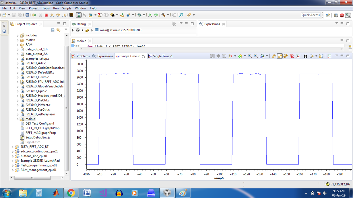

    The FFT output is not what i expected . I have plotted the graph of RFFTmagBuff to check the FFT of the given input .
    I have attached the screenshot  of the both input and fft .
    Input is  square wave of 1kHz of 1Vpp with offset of 0.5v and input has been seen  in RFFTin1Buff
    Ashwin
  • The fact that you are seeing the input signal correctly in CCS is a good sign.
    You can try the following:
    1. Switch to a pure sinusoidal wave.
    2. Check the properties of your single time graph - ensure you have the right Resolution (16-bit), display size (equal to size of FFT), vector to display (RFFTmagBuff). Also for the type of plot, be sure to select Single time (which it seems you have done) and not FFT magnitude, since the RFFTmagBuff buffer already contains FFT magnitude values.
    3. Try right clicking on the Figure and checking OFF and ON the AutoScale option.
    If none of these help, take a step back, and change USE_TEST_INPUT to 1 in main.c, include signal.asm in the build, and build and run the project. See if it Passes ("pass", "fail" variables). This will let you know if the FFT library is running correctly in your setup.

  • Hi Sira ,
    I tired the above changes as mentioned by you but still the fft output seems to be the same irrespective of the shape of my wave .
    Sorry for the delayed response due the tight schedule .
    Ashwin
  • Ashwin,
    I didn't see a response on this comment of mine
    "If none of these help, take a step back, and change USE_TEST_INPUT to 1 in main.c, include signal.asm in the build, and build and run the project. See if it Passes ("pass", "fail" variables). This will let you know if the FFT library is running correctly in your setup"
    Did you try this? What was the result?
