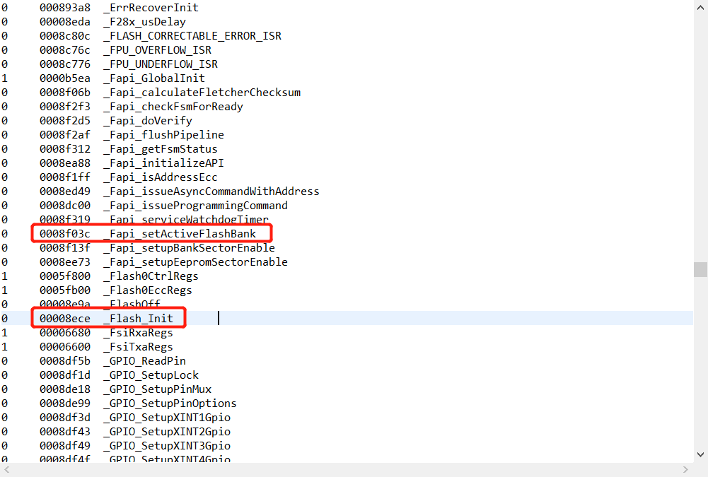

  • Hi Vamsi,
    It execute in Flash.

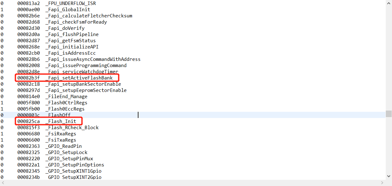

    1. Here is MAP file after enable "0-Register Optimizations"
    2. The same project without enable "0-Register Optimizations"
    3. Another project which include Flash_Init(), even enable "0-Register Optimizations". It's working well .
  • Daniel,
    Note that Flash API (and functions that call Flash API) should be executed from RAM, if you plan to do erase/program operations on both banks.
    If you plan to do erase/program operations on only one bank, then you can execute the Flash API from the other bank (or RAM). I am guessing you want to erase/program Bank1 only, by executing the Flash API from Bank0. Is that correct?
    Also, I noticed that you are using Fapi_FlashBank1 as the parameter for Fapi_setActiveFlashBank(). As mentioned in the F280049 Flash API reference guide, please use Fapi_FlashBank0 only. Fapi_setActiveFlashBank() initializes FMC and both of the Flash banks for erase and program operations. (In F2837xS devices, Fapi_setActiveFlashBank() should be called for each bank since each bank has it's own FMC. In F280049, there is only one FMC). There is no need to execute Fapi_setActiveFlashBank() for each bank in F280049.
