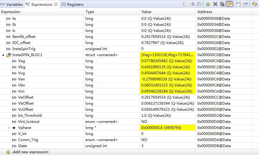

hi, I met problem when I use HVKIT to run a BLDC motor.
First , I use BLDCsensorless in controlsuite ,it's fine .  It can run close loop  as comunication_trip  .
Second , I try use InstaspinBLDC ,  I migrate InstaspinBLDC from f28035 to f28027 ,  then insert f28027 control Card into HVKIT .    step by step , I run level5 .    in this step ,  instaSpin modul can not ouput Comm_Trip.
befor that , I have edit some parameters of  board . such as voltage to 230v . voltage filter pole 179.
Does anyone know InstaspinBLDC can run with hvkit ?       (I have mingrate InstaSpin to F28027 successful in BOOXL-DRV8301)
  • 1. Please run the motor with an open loop using level 2, to verify if the ADC configuration is correct.
    2. Please make sure the ADC channels is set correctly in ADC_MACRO_INIT() for F28027 controlCard.
    3. Please use the level3 to calibrate the BEMF sense offset, it seems like the BEMF offset of phase A is not correct.
    4. Please verify the BEMFINT module using level4 before running the motor with close loop.
  • Hi Yanming Luo
    1.  I think  I am right at level2  ADC configuration:
        iqVaIn =  _IQ15toIQ((AdcResult.ADCRESULT4<<3));
        iqVbIn =  _IQ15toIQ((AdcResult.ADCRESULT5<<3));
        iqVcIn =  _IQ15toIQ((AdcResult.ADCRESULT6<<3));
        InstaSPIN_BLDC1.Vag = iqVaIn - InstaSPIN_BLDC1.VaOffset;        // Adjust for offset of Va_in
        InstaSPIN_BLDC1.Vbg = iqVbIn - InstaSPIN_BLDC1.VbOffset;        // Adjust for offset of Vb_in
        InstaSPIN_BLDC1.Vcg = iqVcIn - InstaSPIN_BLDC1.VcOffset;        // Adjust for offset of Vc_in
    2. I think I am right at ADC_MACRO_INIT() for F28027. because I have use F28027 card in HVKIT when Motorware F28027F ,and reference this setting .

    You can see above configurations ,   ADCRESULT 4/5/6/7  =>  VA, VB, VC, VBUS.
    3. Yes, I notice phase A is 0.29 ,     I dault HVKIT  board fail ,  so I test the Vfu, Vfv , Vfw. .they are normal 0.09V.
    I donot know why BemfA_offset is 0.29V.   then i try edit" cal_filt_gain " .  but it can not become good .
    4. when ,I run at level 4,   instaspin can not output comm_trip as YES.
    from above ,  please give me advice which wrong when I configure.
