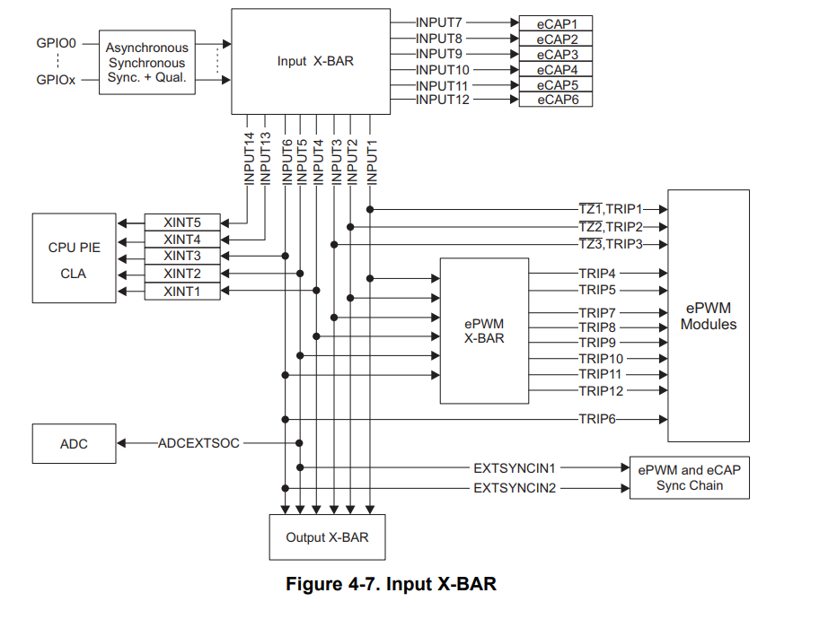

  • Hi Jinsung,
    Is the output signal that is too short to cross the opto-isolator the ePWM sync signal, or some other signal?
    Is the code above for the master or slave board?
    How are you confirming that the sync is making it to the slave device?
    • Scope the pin input?
    • Look at the GPxDAT register with the corresponding GPIO in input mode to observe the changes in the input signal as changes in the GPxDAT regsiter?
    • Looking at the INPUT XBAR flag registers to observe input XBAR lines 5 or 6( EXTSYNCIN1 or EXTSYNCIN2)
    • Route INPUT XBAR line 5 or 6 to output XBAR and observe on a GPIO?
    It looks like you are syncing through all ePWM1-3.  Do any of the ePWMs seem to be syncing with the external input?
    When the sync fails is there a fixed delay, or the two boards are completely asynchronous?
  • Hi Devin,
     ->  The synchronous output signal is too short for 8 cycles.
    So, GPIO keeps output high section for long time. (GPIO_SetupPinMux(6, GPIO_MUX_CPU1, 3) -> GPIO_SetupPinMux(6, GPIO_MUX_CPU1, 0)
    -> The GPIOxDAT register change was observed.
    Looking at the INPUT XBAR flag registers to observe input XBAR lines 5 Route INPUT XBAR line 5 to output XBAR and observe on a GPIO?

  • Hi Jinsung,
    If you set this on the master board
    The GPIO will no longer be connected to the ePWM SYNCOUT.
    Does the SYNCOUT from the master to the SYNCIN of the slave only go through the optical connector? If so I think the fundamental issue is figuring out how to stretch out the sync output pulse on the master side to make it longer?
  • Hi Devin,
    I found the problem.
    I set the Input Xbar register explicitly, but it did not apply to the program.
    The solution was as bellow.
    Before resolution.
    EALLOW;
    GPIO_SetupPinMux(7, GPIO_MUX_CPU1, 0); //Slave Board Setting
    GPIO_SetupPinOptions(7, GPIO_INPUT, GPIO_ASYNC); //Slave Board Setting
    InputXbarRegs.INPUT5SELECT = 7; //Slave Board Setting
    EDIS;
    After resolution
    EALLOW;
    EDIS;
    EALLOW;
    EDIS;
    Is this a bug?
  • Hi Jinsung,
    The driver lib functions also have to use EALLOW to be able to write the protected registers.  They unfortunately don't preserve the status of EALLOW, so you need another EALLOW after the driverlib function call to be able to write to the protected XBAR registers.
