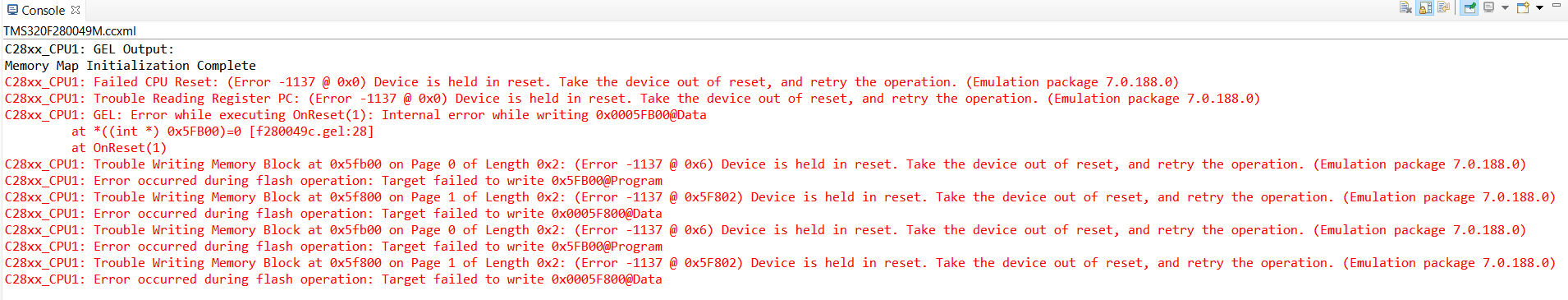

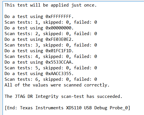

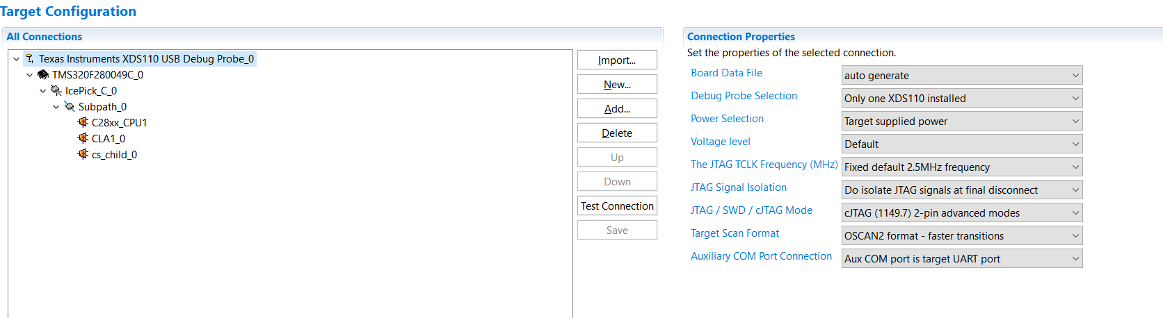

I am using LaunchXL F280049C development kit. The target configuration test connection passes and I get no error.
I have tried different boot modes, SCI/wait boot and Parellel from gpio but still the device is held in reset. Is there any way I can take the device out of reset?
The ccxml is in project directory under taget configurations while the GEL is root\ti\ccsv8\ccs_base\emulation\gel\2808.gel whose status shows success.
My Bad, I am using f280049c.gel (it was a different project i was compiling just now and accidentally wrote 2808.gel)
